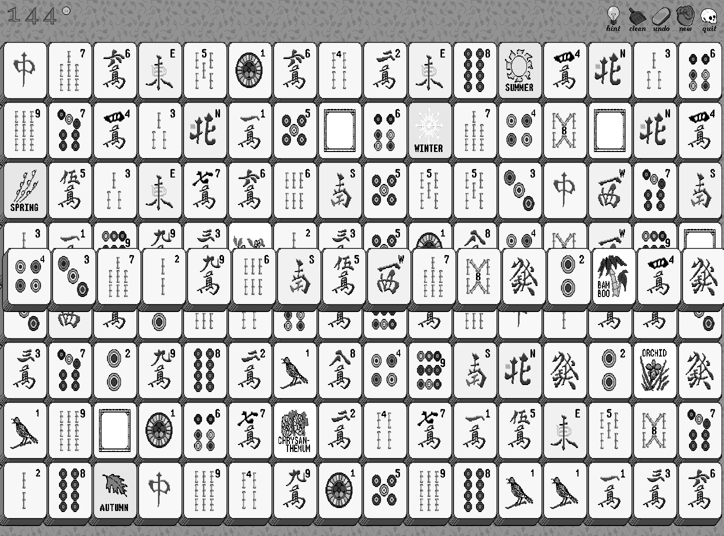

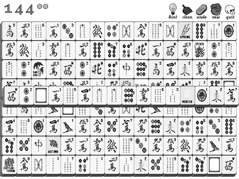

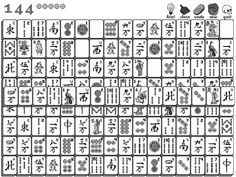

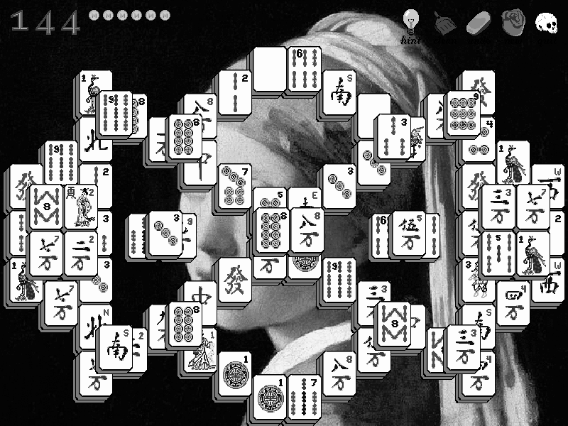

Hello,
i would love to see some screenshots from 1024x768, 1200x824 and 1448x1072 devices.
(thick is a funny tile and displays differently, so it would be nice to have a thick screenshot and one of the other tiles)
There is a screen&tile test in [Misc.], with 16x8 tiles, i made exactly for that.
A screenshot from the kual menu would be nice as well, as i don't have a clue how other devices display.
There is no problem to adjust tile size.
Thank you
wodan

Old 11-28-2016, 06:20 AM   #82
Hanspeter
Hanspeter doesn't litterHanspeter doesn't litter
Posts: 77
Karma: 150
Join Date: Jul 2014
Device: Kindel PW1, Voyager
Originally Posted by wodan16 View Post
Hello,
Thank you
wodan
Hi, I only had time for a quick test on my new Kindle Voyager. Thanks for all you work on the Kual Menus. They work good.
The only thing I needed to change manually was to small that resolution the tile size to xl in the prefs. It was still on s which is to small for that resolution.
Not sure if you recompiled it or only made the changes via Kual and script. The button in the top row (specially the quit button) are hart so select as they are getting to small. It was already difficult on my PW1.
HaPe

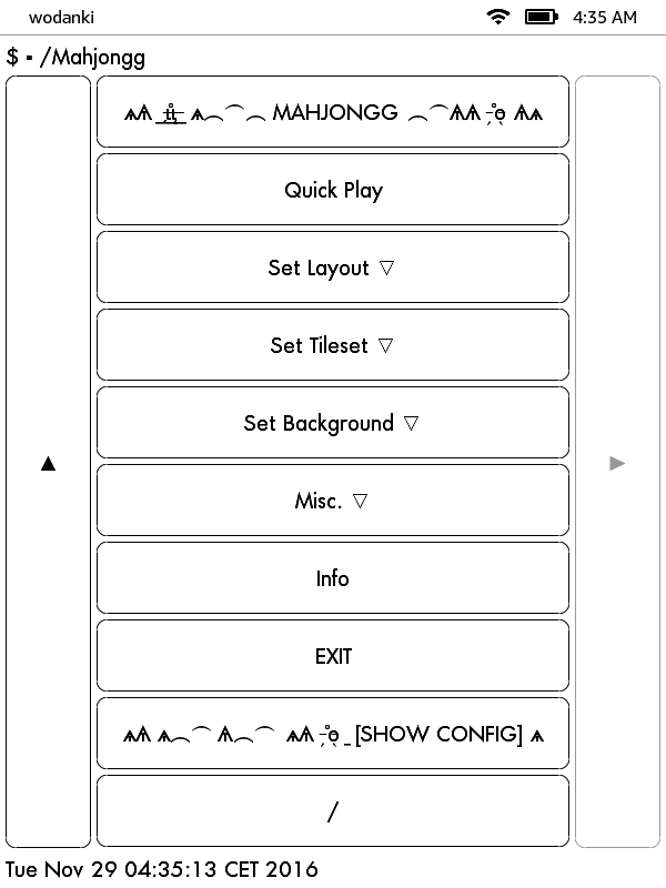

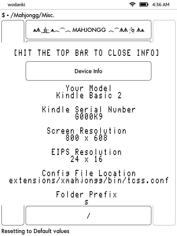

Hallo Hanspeter,
thxs for your response.

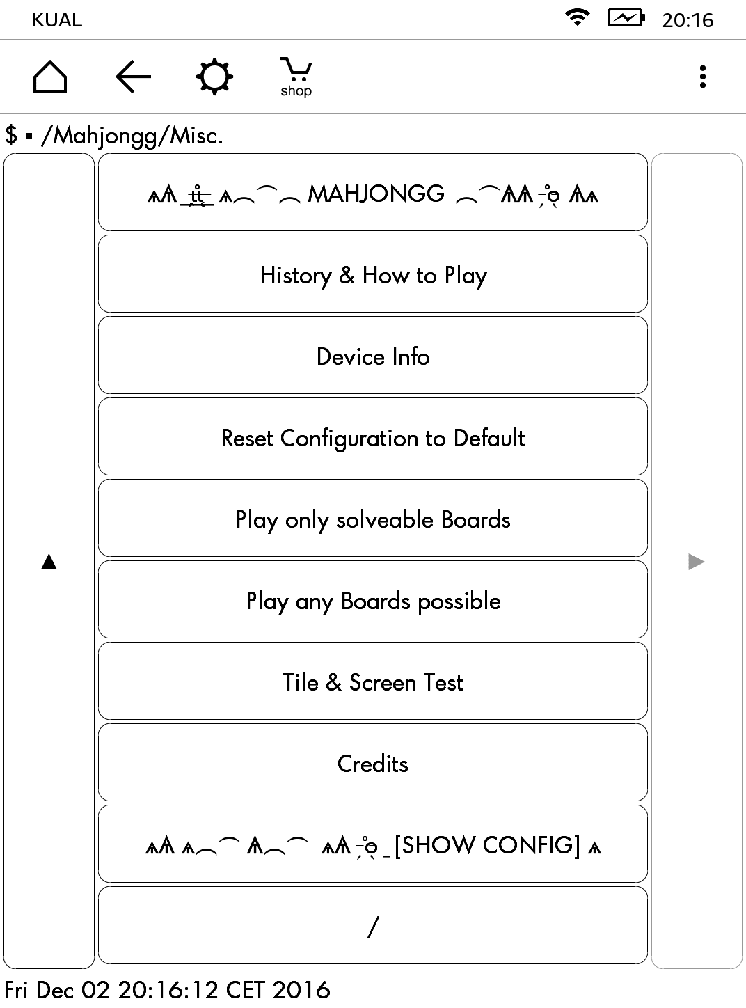

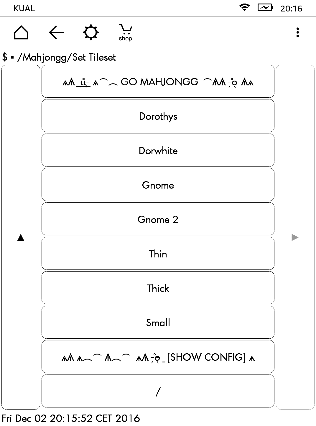

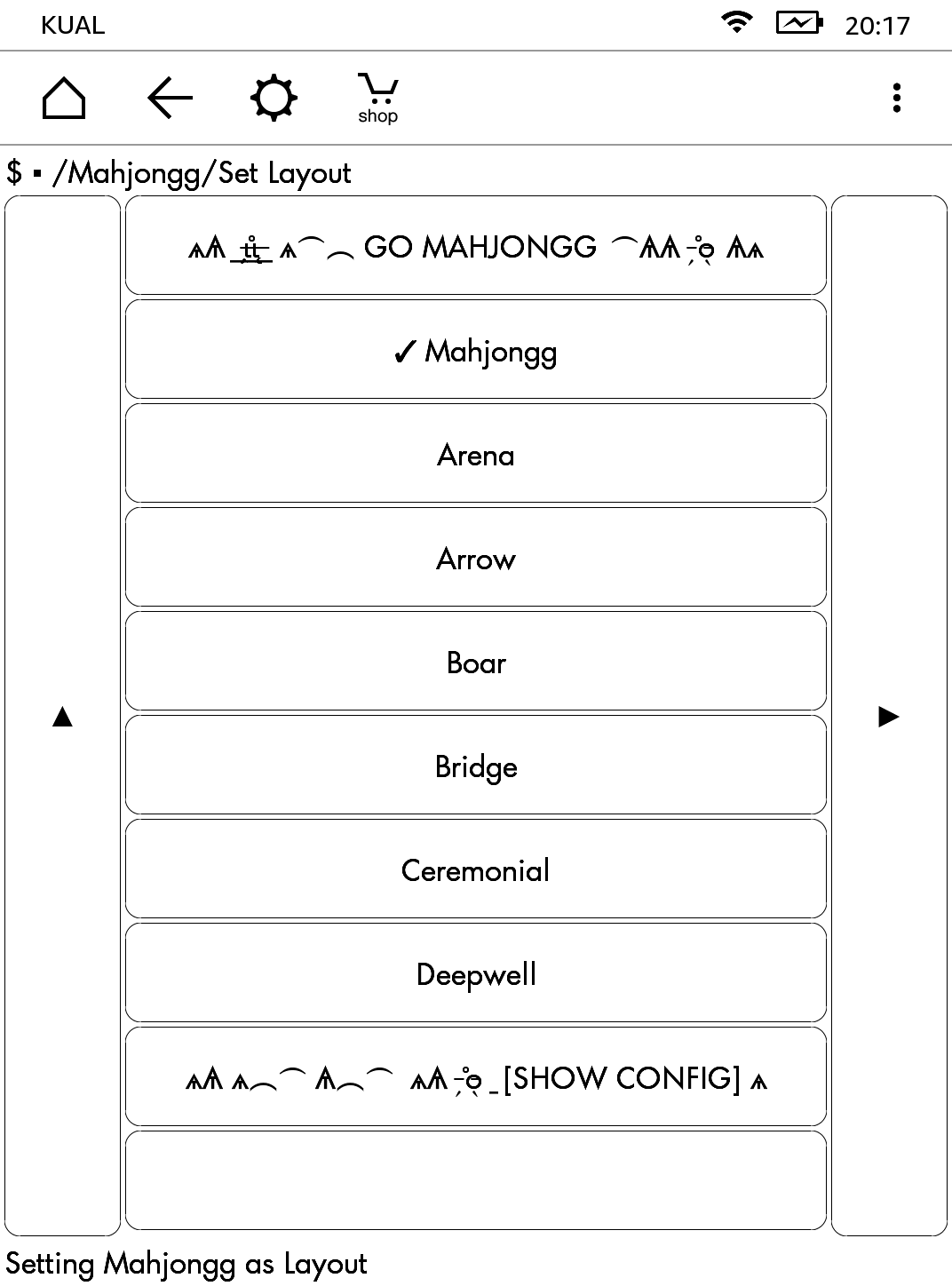

You are right it wasn't setting the prefix.
I cleaned up and rewrote the codemess a little, hopefully the device recognition works now for everybody.
I added a Device Info button in the [Misc.] submenu to actually display
what the script "thinks", Folder Prefix, Device Id, Model Name etc. is, so we can check if in doubt.
Your new KV should now set the Folder Prefix to "xl" and the PW1 to "m" on their own.
The changes I made are only scripts (tcss.sh & eips.sh) called with functions and arguments through kual menu,
writing the value into a config file (tcss.conf).
The most important part are the tiles for every of the 4 different resolutions (why your hardcode fix worked).
WOW the in game menu bar never caught my attention.
You are right it does not resize with the screen size change.
We have to take a look at that.
Different Icons for the Kindles with clean contrast and simple design
to display them better on darker backgrounds is a thought anyway.
Shouldn't be to much work.
Well, there is also a "Solve"-option as a keystroke (-s) for possible implementation.
Extra icon?
I'll take a look at setting up NiLuJes Toolchain, when i get around to it.
UPDATE:
-make sure you have a backup of your backgrounds so you dont have to download them again!
-delete xmahjongg extension folder
-copy new version of xmahjongg folder
-copy your extra backgrounds into backgrounds folder
Feedback is very much apreciated.

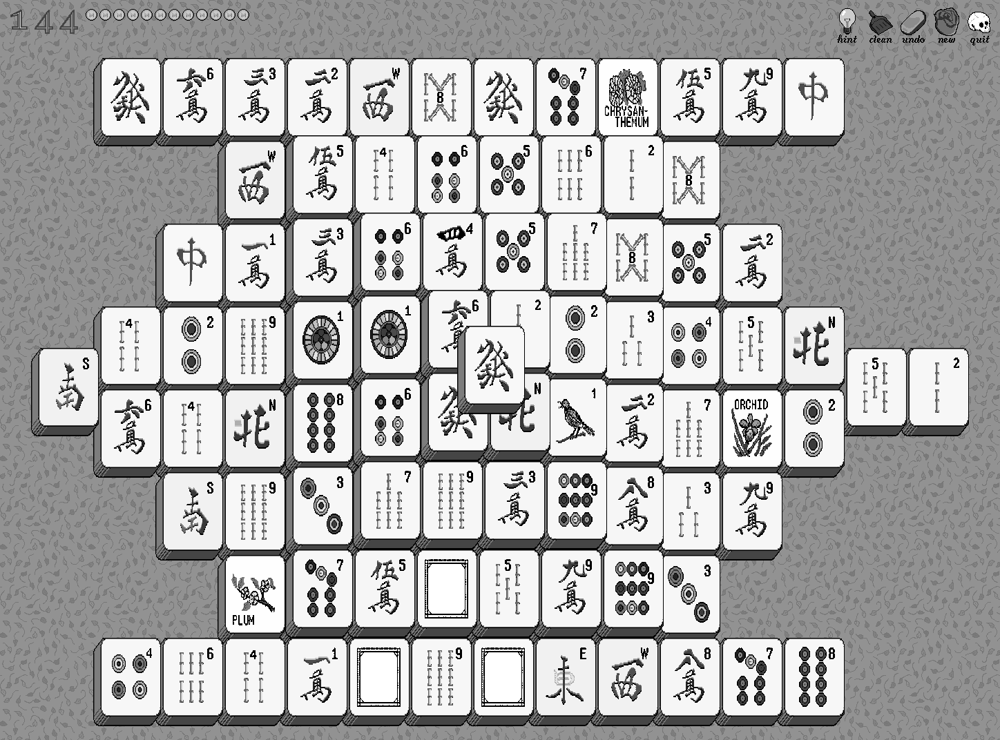

I attached screenshots how it looks on my device(KT3).
wodan

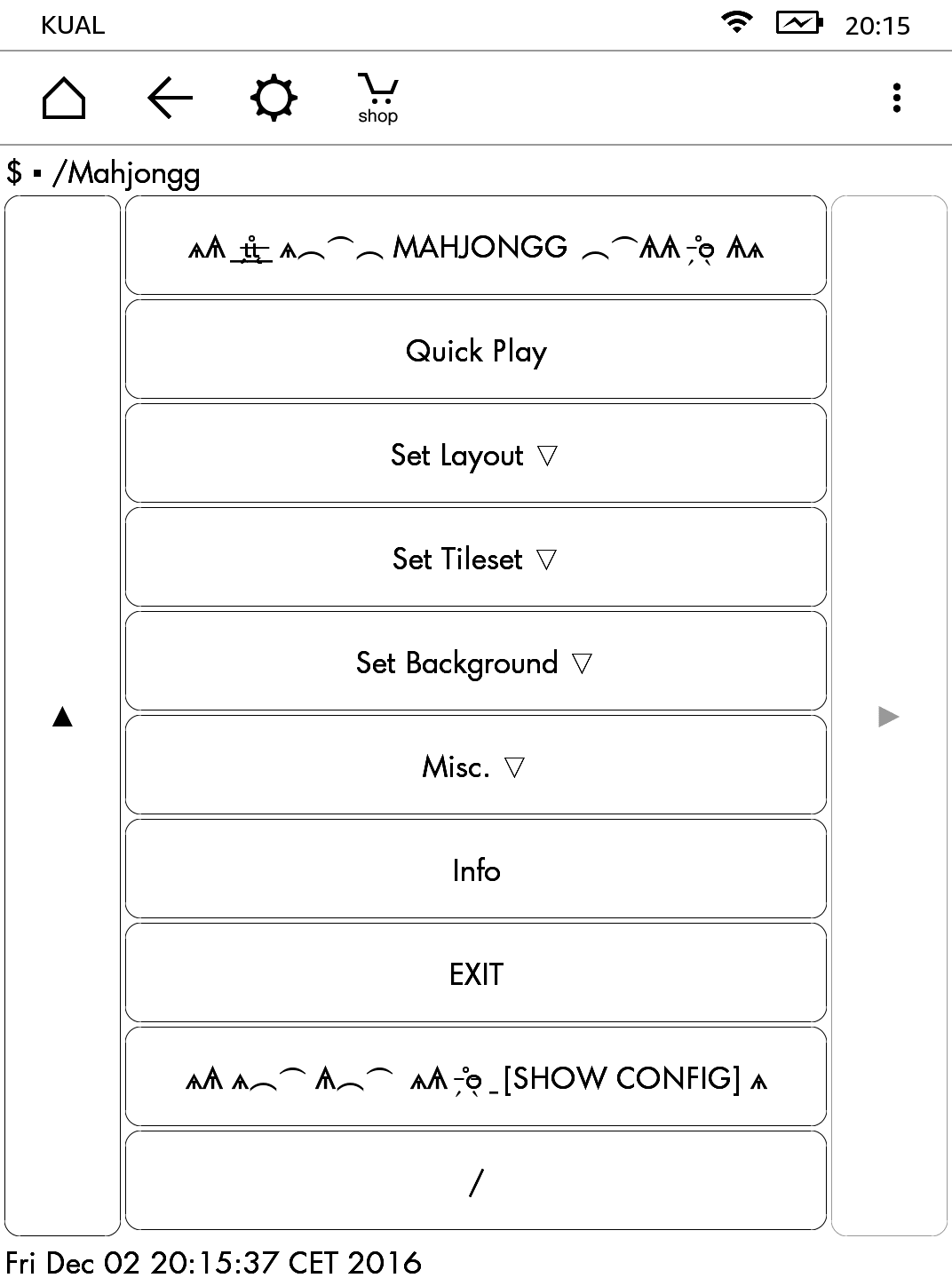

here are some Screenshots from the Voyager.
Tile size detection is working now.
As you see the quit button is very small (on the screen max 5mm) and hard to select.
HaPe

Hi Hanspeter,
Thank you very much for the screenshots!
Can you please take some with the PW1 as well so i can see the 1024x768 res?
Well, the problem is simple.
There are no bigger images of the buttons.
Size change of buttons was not implemented cause it wasn't really needed, i guess.
If you change the window size on a PC you can observe that the button size doesn't change.
It does not really matter on a computer screen...
Solution?
Step 1: Make buttons for the needed resolutions. 5 buttons x 4 resolutions = 20 button images
We might code in the solve button as well?
Step 2: Implement a routine in the source code to choose the buttons regarding resolution.
Step 3: Raise version number to 1.0 and call it a day.
