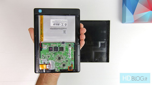

The Kobo Aura One has soldered on memory.
Nooooooooo Is this 100% confirmed? I was hoping to open it up and expand the memory. 8 gigs is not enough; oh well, it will have to do.
Yes. There were photos, by one spanish? italian? reviewer who opened it up.

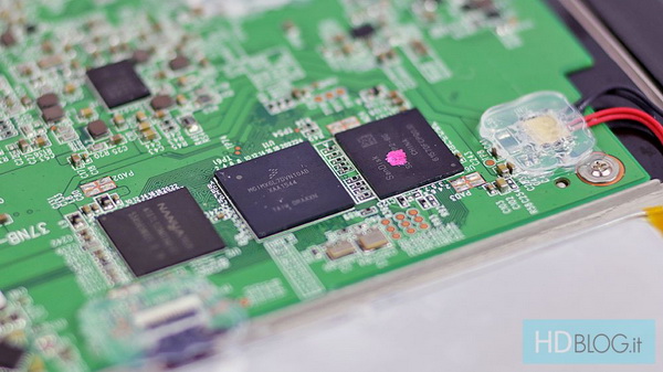

Thanks for the info.
SH
Confirmed, take a look at this pictures (from an italian blog that review it), specifically to the component called "sandisk".

dalamario is offline   Reply With Quote
The one with the traditional Kobo spot of paint on it?
