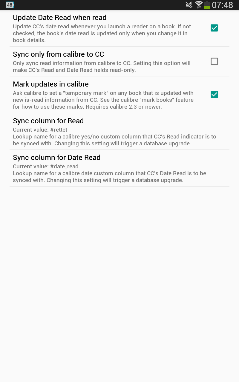

I've tried uninstalling and re-installing the app a couple of times now, but it doesn't automatically change the date read, as you can see in the screenshot it should do it, but whenever I read a book and return to CC it still says "Set Date Read" in the metadata. Also when I sync back to Calibre, it doesn't mark the books which has metadata, that has been changed.
Are you going into book details, tapping "Read" there, then returning to book details? If so, then the problem is that the date read is not refreshed. Go back to the book list and then enter book details again. You will see the new date.

That took care of the automatic date, but it still doesn't show up as marked in Calibre when I sync back to Calibre.
Automatically setting "date read" does not automatically set "read". You must set that manually.

Thanks, it looks to be working now.
