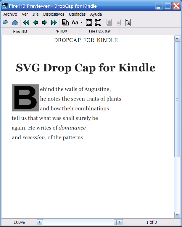

Drop Cap for Kindle (all models)
I love Ruben, but that formatting is going to go straight to hell the moment someone with Coolreader opens it. And it won't survive the Kindle process, either, for KF7, I don't think. Or KF8, given the line-height requirement.
Hitch
Hi Hitch;
Happy New Year Yes, you are right, but in CoolReader nothing works, since it doesn't support "float" and many others css2 properties. Regarding Kindle, well, that's an interesting case. Sometime ago (about two years) I spent a lot of time trying to find a way to get a perfect drop cap with any Kindle device (e-ink or Fire models), with any font size, with any font family (with Kindle e-inks you have six fonts to choose). I wanted something consistently displayed, regardless of device used. Could that be possible? After lots of trial and error, I found the only way to get that target was with an image, so I decided to employ a SVG image. With the following code you can get a perfect drop cap for all Kindle models (forget for the moment KF7):
/* Style to set the grey square */
.KDropSpace {
    float: left;
    font-size: 4.6em;
    width: 1em;
    height: 1em;
    background: grey;
    padding: 5px;
    margin: 0 5px -0.1em 0;
/* Style to fit the DropCap inside the grey square */
.KSVGDropCap {
    display: block;
    position: relative;
    top: 0em;
    left: 0.05em;
    font-size: 1.2em;
    font-weight: bold;
    font-family: sans-serif;
    width: 0.8em;
    height: 0.8em;
    text-align: center;
/* Styles for old Kindle models */
@media not amzn-mobi {
.NotKF8 {
    display: none;
And in the .xhtml file:
<h1>SVG Drop Cap for Kindle</h1>
  <p><span class="KDropSpace"><img alt="B" class="KSVGDropCap" src="../Images/B.svg" /></span><span class="NotKF8"><b>B</b></span>ehind the walls of Augustine,<br />
  he notes the seven traits of plants<br />
  and how their combinations<br />
  tell us that what was shall surely be<br />
  again. He writes of <i>dominance</i><br />
  and <i>recession</i>, of the patterns</p>
These are screenshots of Kindle Previewer for all Kindle models:
ID:	145143 Click image for larger version
ID:	145144 Click image for larger version
ID:	145145 Click image for larger version
ID:	145146 Click image for larger version
Below you can check the respective epub, with the SVG image for the letter "B". Regarding KF7, you know, we can't get there drop caps, so I displayed the first letter as bold.
Regards
Rubén

By chance, did you read/try the code of this post:
https://www.mobileread.com/forums/sho...3&postcount=24
Because that is code you must use for Kindle models (my previous code was for ADE). The drop caps for Kindle must be based on SVG images in order to get a consistent display, regardless of device used.
Regards
Regards
That's very impressive. One of these fine days if I ever need to do drop caps in Kindle I'll try to understand it. Thanks again for all your work and willingness to help.
