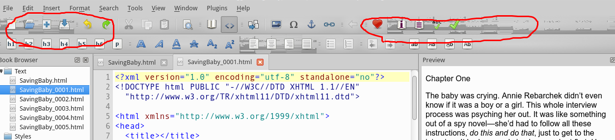

Thanks ducks. Your way worked great. Now when I use your method is that going to prevent my file from being corrupted? And the follow-up question to that is, the way I had split the chapters, did I cause the file to become corrupted?
And an additional note. I have a work and a home computer. They both have Sigil 0.8.4 and Xubuntu 15.04. The corrupted file happened on the work computer, which is not as powerful as the home computer. (Sometimes the graphics is distorted a little, like in drop-down menus and sometimes on the screen in general, on the work computer.) see screenshot
I noticed that I was able to use your method of splitting the chapters on my home computer (the more powerful one) in Book, but when I tried it on my work computer, when I did the first split it did if fine but then when I hit "chapter" in the "Find/Replace" box it took me to the Code version. Whereas on my home computer when I did that it remained in Book.
I mean, it was okay. I just did it your way in Code and it was fine. I was just wondering why the same version of Sigil would work differently on different computers.

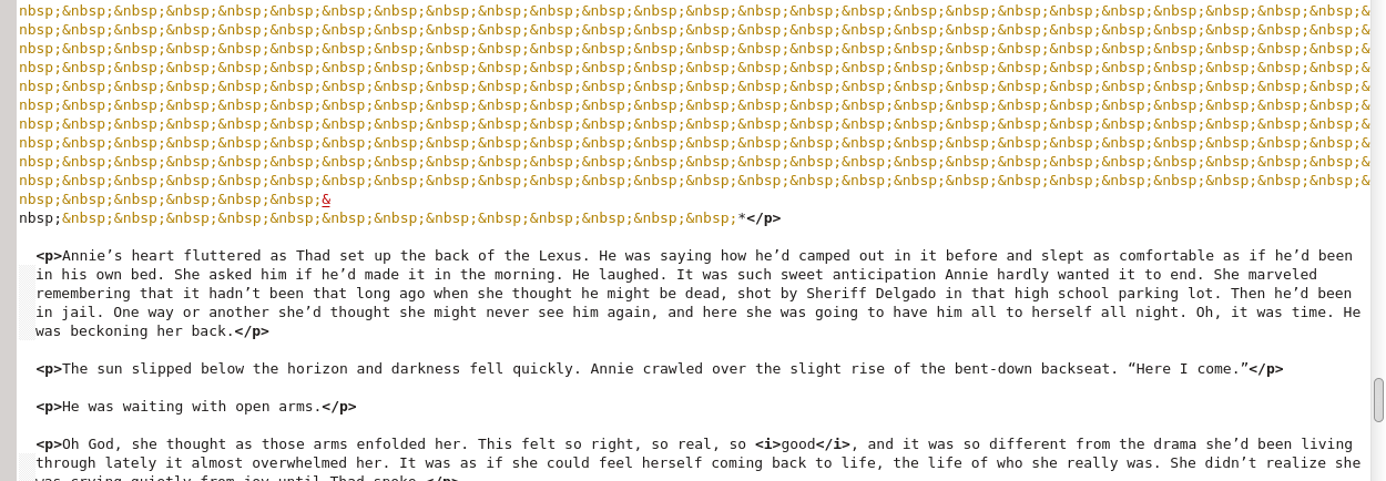

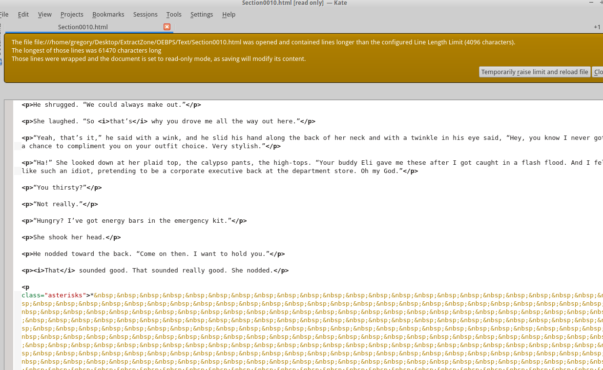

Anyway, I did the renaming to a zip and opened it up and the last file I split got gigantic (see screenshot 73). I opened that gigantic section 10 html file in Kate and there were tons of non-breaking spaces. It started here (075) and ended here (076).
I use this as the break point between chapters:
<p class="asterisks">*&nbsp;&nbsp;&nbsp;&nbsp;&nbsp;* &nbsp;&nbsp;&nbsp;&nbsp;&nbsp;*</p>
I don't know. There is a beginning and ending P tag in Kate so that seemed normal, but somehow the non-breaking spaces multiplied exponentially. It seems to me (and I am a non-techie) that all those non-breaking spaces overwhelmed the file and probably broke/corrupted it.
I checked one of the other html files in a text editor and it looked normal.

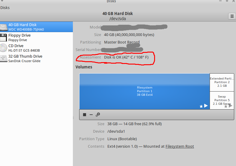

I'm using an old Dell (Optiplex 170L) and running Xubuntu 15.04. If you can check the second to last post (to theducks) there's a screenshot of some distortion I've been having since I upgraded the computer to 15.04. But the computer has been (besides that inconvenience) functioning excellently.
And it looks like the hard drive is okay. (77)

(cursor)Chapter One
What happens is I do the split. (It is successful.) Then I have "chapter" in the "Find" tool. When I click on Find, Sigil automatically switches to Codeview and takes me to "Chapter One." I then click Find again and it of course takes me to Chapter Two. Then I switch back to Bookview. Make sure the cursor is to the left of "Chapter Two" and repeat the process.
Every split worked properly until I got to xhtml10. Then it bogged.
Regarding your question in the other post about non-breaking spaces. The non-breaking spaces I added, those were all serving as scene breaks so "Chapter" would not be there at all. So it was impossible that a non-breaking space would get in the way.
What I thought was unusual was that on my home computer I could stay on Bookview while using the Find tool (in the process described above), whereas on my work computer (the one that I had the problem on) when I used the Find tool (in Bookview looking for "chapter") it kicked me into Codeview.
I need to work on this book, so what I was thinking was prudent was to do the splits in Codeview. (Although the User Manual suggests doing it in Bookview.)
Any suggestions for how to do the chapter splits without breaking another file? (I don't know if you saw theducks suggestion of doing shift-control-enter for the individual splits and then F6 to do the collectively.)
Thanks.
Thank you.
For the record ... , that entry, I think, is about the temperature of the hard drive. To truly test your hard drive you should run "fsck" with the proper command line options to see if anything needs to be fixed. I am sure Linux probably has a gui wrapper around that tool that will make it easier to use. It is worth checking out if you have the time. The testing can take a good bit of time depending on how big your drive is and how full it is. Testing the drive is often done periodically after some number "n" of mounts.
