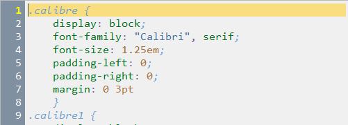

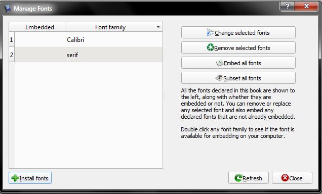

unable to remove serif from epub with other css properties
How do I remove the serif only from a epub ?, I have tried using font-family and font-family:serif in other css properties to no avail.
Serif is listed as a separate font under Edit > Tolls > Mange Fonts, (see pic below), and I note that I can remove serif with Manage Fonts, perfect exactly what I want to do, but... How do I remove this serif without laboriously manually editing every single book in my collection ?.
Many thanks.
Uh!
serif is just the fallback if Calibri is not found on the device. It is in second place.
serif, san-serif, monospace are generic NAMES for the assigned (by system builder) defaults

There are two types of fonts.
There are the font files, e.g. *.ttf or *.otf
There are the font-style directives in the CSS.
The Manage fonts dialog is completely irrelevant, as it only affects the former.
There is no such font as "serif", in much the same way that there is no such book as "fiction" -- because "fiction" is a genre, not a title of a specific book.
Likewise, "serif" (and "sans-serif") are a genre of fonts.
If you specify the serif "genre", an ereader or browser will look through the fonts it knows about, select all the serif ones, and pick one out of a metaphorical hat.
All meaningful changes start with the CSS.
What you want, is to direct the ereader to stop using the serif "genre" of fonts.
You can do this two ways
  • Remove all mention in the CSS to font-family: serif;
  • Explicitly tell the CSS to use font-family: sans-serif; (or any specific font you have embedded, if that font belongs to the sans-serif "genre")
If you choose the former, then whatever your device default is, will be used.
That may be serif.

The last we heard, your CSS still said (the OP):
.calibre {
    display: block;
    font-family: "Calibri", serif;
    font-size: 1.25em;
    padding-left: 0;
    padding-right: 0;
    margin: 0 3pt
Did you ever get around to switching the font-family to "font-family: sans-serif;"
If, for some reason, you absolutely positively must have some specific instantiation of a sans-serif font, did you embed it using the Manage Fonts tool, as well as specifying that font-family in the CSS?
Note: You will need to match the font-face rule.
Note2: I feel it would be instructive to reference the friendly guide to CSS at W3Schools: CSS font-family property
