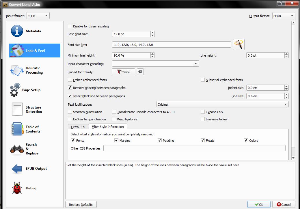

All books converted in Calibre with CSS filters enabled, remove blank spaces between paragraphs, insert blank line 0.4em
line height 90%, fonts, margins, padding, colour etc. filtered. (see photo).
1. The minimum line spacing is way to large.
2. The line spacing setting in the Glo has no visible effect on the line spacing when adjusted. It only worked once or twice on different books then it failed to work on any book. I experimented with different fonts and spacing on the Glo extensively.
Can someone explain to me;
How to decrease the default minimum line height in my Glo ?.
How do I get the Glo's line spacing slider to work on all books ?.
Thanks.

I set all line height options to zero, and converted one book, Line slider does nothing.
I've opened several other books, changed font type, fiddled with line spacing, returned to the original problem child and the line slider is ineffective on all books
leftright is offline   Reply With Quote

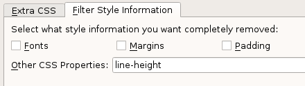

As others have said, you will need to remove the line-height style from some parts of the CSS to fix it. (And although it is not common, some books might also have a font: style, shorthand for font-family/font-size/line-height, that will need to be changed.)
The way I see it there seem to be two causes of the problem:
1. Calibre 'flattens' the CSS when you do a conversion, even just an EPUB --> EPUB conversion, which destroys some of the structure of the original stylesheet. Even if the book worked perfectly before the conversion it might not work properly after the conversion, because the CSS structure is different.
2. The publisher needs the power to override the user-selected line spacing in some special cases in order to get the proper layout, such as when the opening paragraph starts with an oversized capital letter. But unfortunately some publishers abuse this power by forcing a fixed line spacing to be used for the whole book.
To fix the problems:
1.A quick and dirty fix is to strip all line-height styles from the stylesheet, but beware that this will spoil the layout of some books. One way to do this is by adding line-height to Filter Style information --> Other CSS Properties when converting with Calibre.
2. A slow but clean fix is to edit the stylesheet by hand and remove the line-height styles only from the classes used for paragraphs in the the main body of text. If the book was created/converted with Calibre you might also need to remove line-height from the .calibre class usually used for <body>. This fix is usually quite easy if you are editing the original epub, but it will be a lot more work if the book has had its stylesheet 'flattened' by Calibre.
(Similar causes and fixes apply when the use of text-align prevents the justification button working.)

2. A slow but clean fix is to edit the stylesheet by hand and remove the line-height styles only from the classes used for paragraphs in the the main body of text. If the book was created/converted with Calibre you might also need to remove the line height from the .calibre class usually used for <body>. This fix is usually quite easy if you are editing the original epub, but it will be a lot more work if the book has had its stylesheet 'flattened' by Calibre.
This is the best way. I tried quite a few books and found one of mine where the line spacing adjustment did nothing. And it's exactly as already stated by others, the line-height style in my case was set to 150% in the stylesheet.css. I opened the book in Sigil and once I removed those few lines from the stylesheet, the line spacing worked perfectly and was adjustable from the reader as it should work.
The fix really isn't that difficult, there's usually just 2 or 3 styles that pertain to the main body of text, and those are the only ones you need to remove the line-height styles from.
