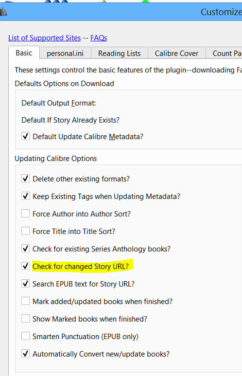

I'm not sure if this is just me being an airhead, but I am battling in frustration with the following issue:
An author puts up their fic on two different websites with the same username and title, but with obviously different URLs. When I try to download the fic using the second URL, FanFicFare won't let me do so, telling me that there's nothing to update.
Is it possible to have the plugin simply search for identical URLs instead of the title and author as well? I know that I set it up so that FFDL did that, but for whatever reason, I just can't figure it out with FanFicFare.
Help please?
blackburnsie is offline   Reply With Quote
Old 07-07-2015, 01:21 AM   #372
JimmXinu
Plugin Developer
JimmXinu's Avatar
Posts: 7,184
Karma: 5006097
Location: Midwest USA
So you want it to download the same title/author book from a different site when it already has the same number of chapters?
As a separate book, or replacing the first one? If you have a separate book for each, they will each match (and update) only the book with the matching URL. Title/author look up is a fall back.
You can also turn on the Check for changed Story URL (see attached), that will stop and prompt you when an existing story wit the same title/author but a different URL is present. First it will ask if you want the existing book updated/overwritten and then if you'd like it added as a new book if you say no.
The 'Update' part doesn't change. If you use Update EPUB if New Chapters it's only going to update if the site has more chapters than you do.
Old 07-07-2015, 11:09 PM   #373
blackburnsie
blackburnsie began at the beginning.
Posts: 5
Device: iPhone
Yes, I want to download the same book from the same author from a different website. For various reasons, it's easier for me to do so.
For example: Acts of Life by Lomonaeeren
I've subscribed to this story on both fanfiction.net and archiveofourown.org. This author has the same username on both sites.
AO3: http://archiveofourown.org/works/3966676
ff.net: https://www.fanfiction.net/s/11257753/1/Acts-of-Life
I want a separate copy of the fic for each of the 2 urls. But the plugin doesn't do that automatically. I have to select "Add new book" in the download options in order to accomplish that. I'm looking for something automatic, not manual.
It works fine if I add both of the URLS at the same time.
However, when I add the fic in from, say, the AO3 url, and then a few days later, try to add the fic in from the ff.net url, I don't get the second book added. It essentially acts as an update (if there is one), regardless of which URL I use. Then I have to read the message to determine if that story hasn't updated, or if this is a case of "same fic, different url".
What I want is for FanFicFare to read only the story url, but what it seems to be doing for updates is reading the title/author and number of chapters instead.
I like having separate copies of the same fic from different websites because:
1. Sometimes there are differences in the fic depending on which site it was posted to.
2. I mass download by copying a bunch of urls and letting the plugin do its thing in the background. It's a pain to babysit and to click yes or no every time the "changed story url" message pops up.
So basically, the problem is that FanFicFare doesn't allow me to download a fic with a different url if it's already in my library under the same title/author but from a different site.
Old 07-08-2015, 01:18 AM   #374
JimmXinu
Plugin Developer
JimmXinu's Avatar
Posts: 7,184
Karma: 5006097
Okay.
New test version posted (direct link).
Add new config option: "When checking If Story Already Exists FanFicFare will first match by URL Identifier. But if not found, it can also search existing books by Title and Author(s)." Now you can disable that behavior.
Old 07-08-2015, 01:46 AM   #375
blackburnsie
Posts: 5
Device: iPhone
Tested it, and everything seems to work!
Again, thanks a lot!
