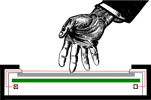

I got used to the reflections, and even the black color, on my H2O. It looks bad on YouTube videos but usually there's a lot of extra lighting in those videos since dark videos look bad, so in practice with regular light at home it's not bad.
But even so, if in the future there is a choice I will prefer white readers again. Only text should be black, a black border is somewhat distracting.

Originally Posted by frostschutz View Post
I'm not sure exactly how IR optics work (a TV remote you can point nearly anywhere and it works, but with a touchscreen you need precision). In the H2O I imagine it's like this. There's some black/glossy/but IR-translucent L-shaped structure in the bezel that gets the IR stuff from below the Kobo's mainboard to the atop of the screen.
The Kobo Glo and my Sony 350 readers all have just an empty space there, the IR beams don't need to pass through anything to work. At least all others didn't, so I can't believe they bothered to do something more sophisticated that now requires the plastic piece be there for the IR to work properly. I always thought it was put in place on the H2O because it would need to be sealed to be watertight, and then someone just thought it looked cute and should be stuck on the Glo HD as well.
It needs to be there. You open the H2O by taking off the front bezel. It's just plastic but the Touch Screen no longer works without it. If you have water droplet detection enabled all you get is the "water on your screen?" message.
My image above was wrong by the way it's not below the mainboard, but below the display. But the plastic is doing the IR beam redirection shenanigan somehow, it has this transluscent part attached to it, and it's this glossy edge that sits atop the device and it reaches into the device itself with some kinda extension fins.
You can see this a bit on the pictures I posted here:
https://www.mobileread.com/forums/sho...66#post2998466
You can see the IR things on the sides of the mainboard, and a bit of them on the top of the display, and the glossy fins on the bezel. The bezel pic is particularly bad you can see it much better in this YouTube video:
https://www.youtube.com/watch?v=bffxKvz9RhA
What he calls "barriers" at 1:20 is actually the IR reflector? redirection? lens? shenanigans you can see these "barriers" are exactly the same glossy plastic material and it's see-through for IR. So these "barriers" reach into the device below the display and bring the IR to the top of the display somehow and that's why touch only works with this stuff and not with-out.
