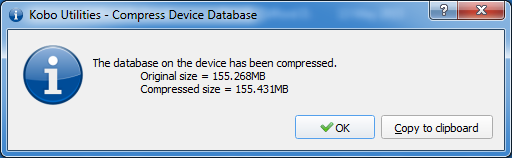

Old 06-05-2015, 10:19 PM   #959
Posts: 48,407
Karma: 174510100
Odd item...
Just backed up, checked and compressed the database on my H2O. The backup and check went fine, the compress had a bit of an oddity with the final size being larger.

Old 06-06-2015, 01:27 AM   #960
PeterT
Posts: 13,706
Karma: 80104526
Location: Toronto
I seem to remember from the ancient days of school that if you re-balanced a tree it was possible for the new one to be "larger" than the source.
