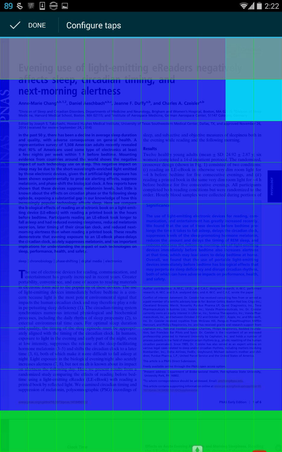

No, nothing wrong (you can watch the screenshots I posted (https://www.mobileread.com/forums/sho...4&postcount=12)). As I said in my previous post, I can read perfectly (flawlessly) your pdf. You also can use the volume buttons of your tablet to go from page to page but the more comfortable things is to configure taps. Go to "Common Settings" > "Configure Taps" and Reset all. Press that button several times (in order to erase all the previous defined zones), after that you can't do that once more. You'll see something like:
Attachment 138571
After that, with you finger select the central part of the screen (see the following image):
Attachment 138572
Select for that zone the command (single tap) "Show options menu". Press the "Apply" buttom.
After that, with your finger select the right part of the screen (see the following image):
Attachment 138573
Select for that zone the command (single tap) "Scroll Forward". Press the "Apply" buttom.
Do the same for all other zones and you'll have something like:
Attachment 138574
After that, select with your finger all the screen; you'll have something like:
Attachment 138575
Select for that zone the command (DOUBLE TAP): "Zoom to column". Press the "Apply" buttom.
After that, select the right part of the screen; you'll have something like:
Attachment 138576
Select for that zone the command (TWO FINGERS TAP): "Scroll to next page start". Press the "Apply" buttom.
Finally select the left part of the screen; you'll have something like:
Attachment 138577
Select for that zone the command (TWO FINGERS TAP): "Scroll to prev. page start". Press the "Apply" buttom.
That's all. After that you'll be able to read any pdf/djvu files (with or without columns) flawlessly.
Regards
Rubén

I don't see where you said my pdf worked, so I assumed you didn't try it.
Please, read again the post #12 of this thread. Perhaps you won't read my "EDIT:" notes where I posted two screenshots of your pdf on my tablet. The screenshots belong to the first column of the second page in portrait mode. I could read perfectly your .pdf except for the issue with the second column of the first page where due to the tag "PHYSIOLOGY" I had to set the wiew manually (the app takes the tag as part of the column and so it doesn't remove the white right margin so the text is not so big as it should). All others pages/columns can be read perfectly after "Zoom to column".
I didn't realize that tap zones don't work at all until you set them. You can't even tap in the middle to get the menu by default. Every app should have reasonable defaults set. I cleared data in the app and see this when I choose tap zones from the menu...
Ok. Now start to set the zones as I told you in my previous post. First select the central part of the screen and choose the command (single tap): "Show options menu" and press "Apply". After that, set all the others zones as I explained you in my previous post.
Thanks for your help.
You are welcome

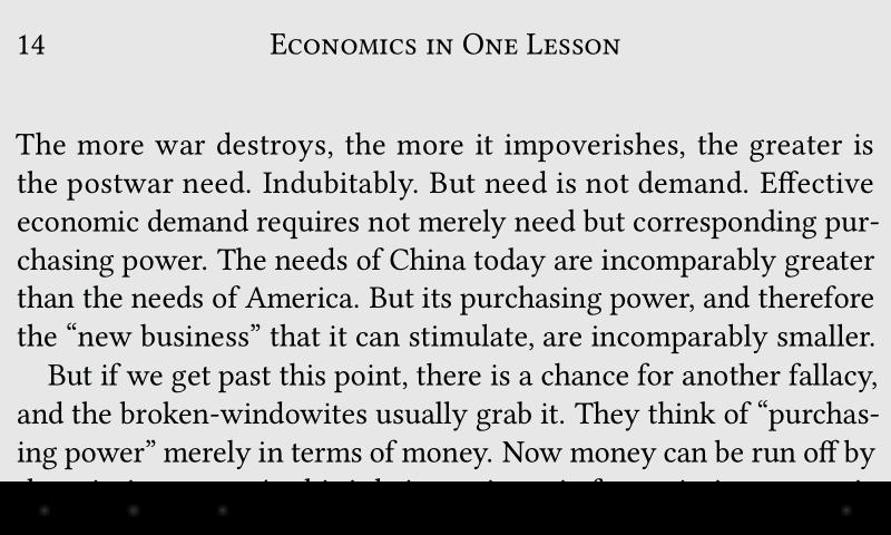

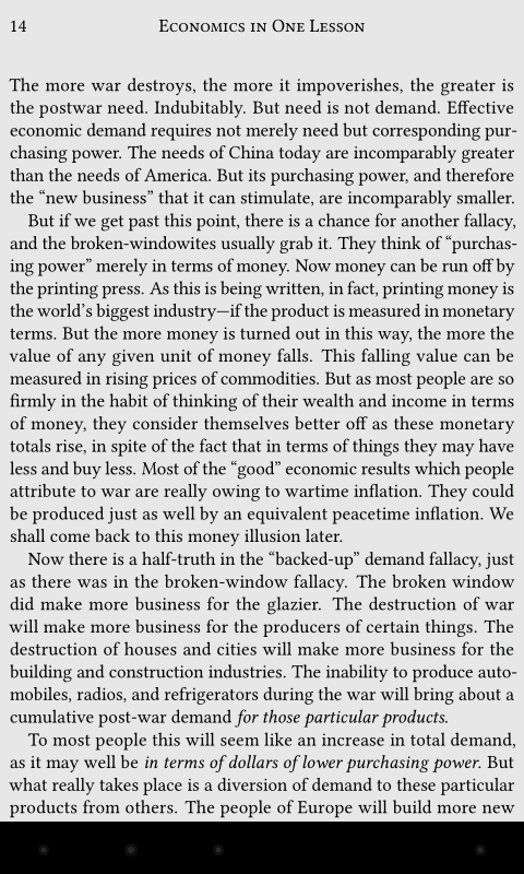

And EBookDroid too. How do you read? In landcape mode? In landscape mode you can't have a full page wiew with margins removed (you can have a full page but with margins if not the app can't maintain the proportions of the page). In portrait mode you can have a full page view without left and right margins and maybe without top and bottom margins (the app needs to maintain the proportion of the page and to fit it to your tablet). Suppose you have a page very very long; if you want all the page on the screen, then to maintain proportions the app will have to show margins at left and right; if you don't want left and right margins, then the full page won't be able to be showed. Did you the try of reading a pdf with legal size on Koreader? I'd like to see a screenshot of that pdf so all of us we can watch how Koreader shows the full page without margins.
Here you can see a screenshot of a book in full page mode:
and here a screenshot of the same book in landscape mode:
In the first case, when you tap on the right, go to next page; in the second case, when you tap on the right the book scrolls down. It's a pitty that doesn't work for you.
