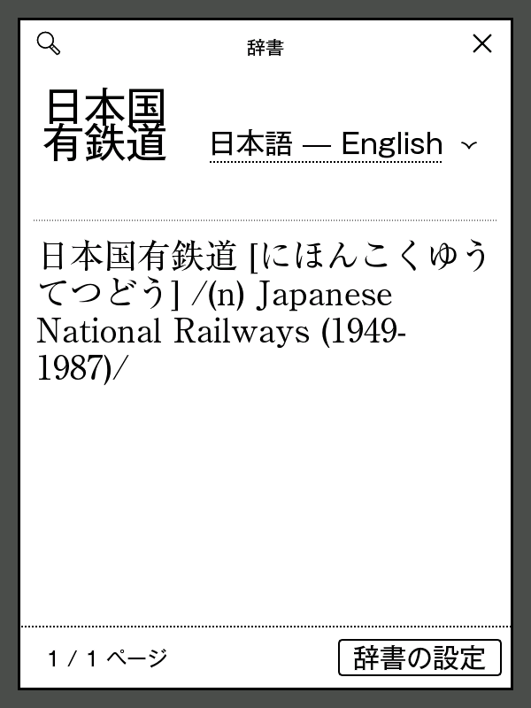

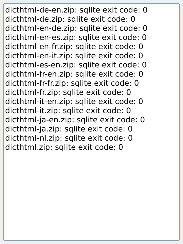

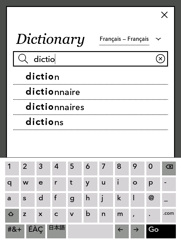

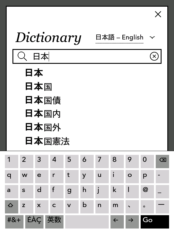

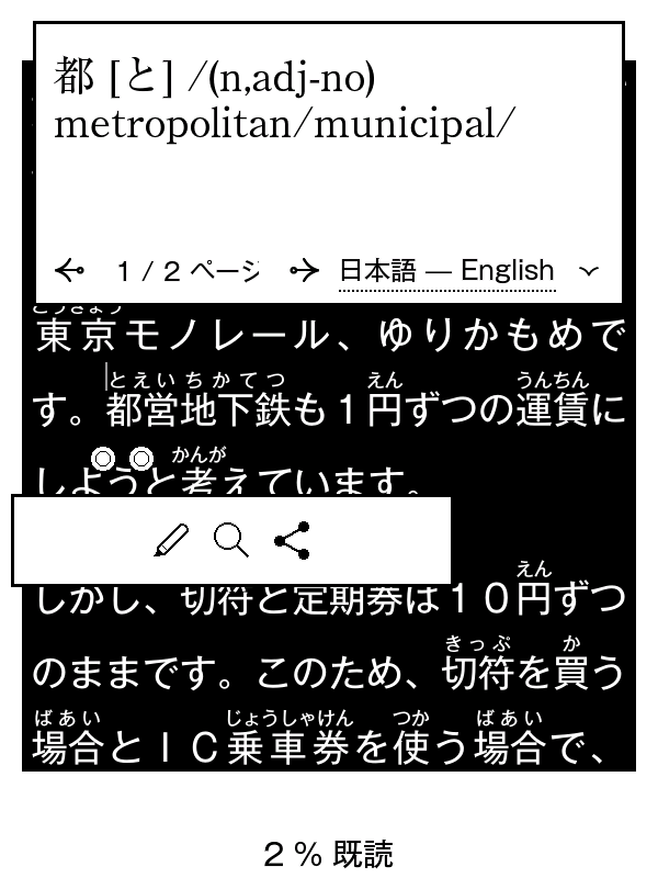

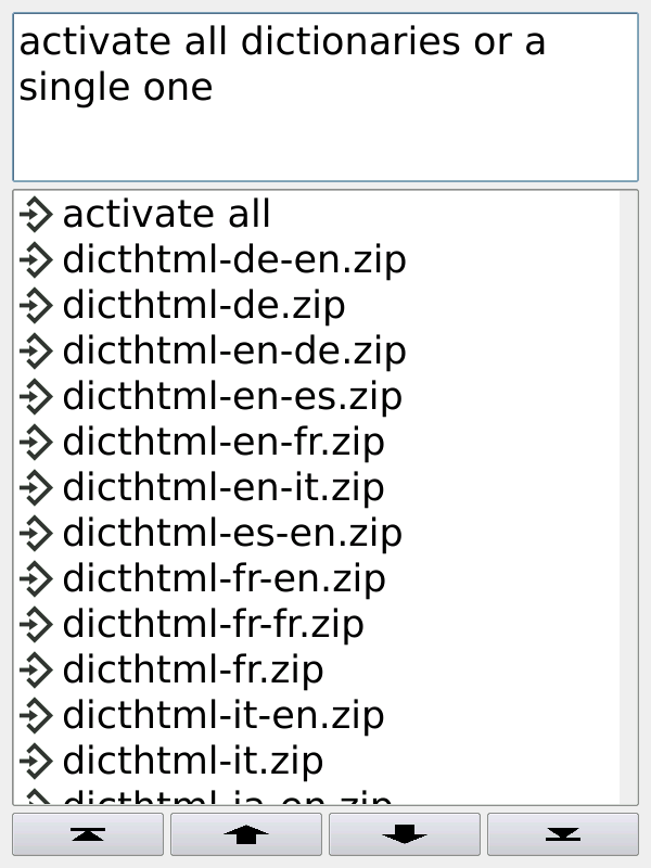

activate dictionaries
This is only for KSM version 06!
Purpose: activate side loaded dictionaries.
After installation, go to "tools > activate > activate dictionaries msh"
As for the illustrating images, you will notice that I overdid the "modifications for bad eyes" quite a bit. This has nothing to do with KSM. The first image shows the "activate dictionaries msh" screen, the second image shows the report that was shown after I executed "activate all."
Since this will make changes to the database, you might consider backing up .kobo\KoboReader.sqlite, before trying this.
EDIT: I removed the archive here, and included the content in KBStartMenu_06_update01b.zip, which you can find here.
