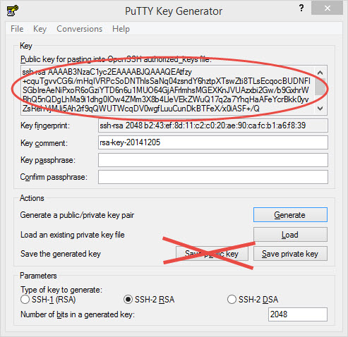

Originally Posted by Spartan117H3 View Post
Not too big of a deal, but when I log into SSH, why do I always get "Server refused our key" and have to hit enter on the password prompt? Any fix for that?:
login as: root
Welcome to Kindle!
root@192.168.15.244's password:
That means your keys haven't been created correctly.
In particular it probably is your public key the one wrong.
You can't save the public key with the save button, that has an incorrect format. You have to copy the key displayed in the upper panel, and paste it in a file called "authorized_keys" and copy that to the file /mnt/us/usbnet/etc/authorized_keys
While I'm talking about SSH, how do I SSH over WiFi? I just get a connection timeout.
You have to enable it in your usbnet configuration. Check usbnet readme_first file for instructions.

@Spartan117H3: That seems to be an issue on your side (that, or PuTTy being weird) [i.e., you're not in fact using shared keys to auth].
As for over WiFi, there's a config switch in the KUAL extension, but you *will* have to clear up your authentication issues first, because it will require a valid auth (unlike now where you can enter pretty much whatever you like as a password, or just hit enter).
I didn't set a password for the public/private keys, would that be a reason? I figured it would "skip" the auth as long as I had the key file.
Spartan117H3 is offline   Reply With Quote
Not at all. Keys won't need a passphrase. In fact, Winscp would not even support it, for instance.
I just copied it into a .txt file, removed the .txt extension, then placed it into authorized_keys. Still get the same problem.
I'm sorry, this does not make much sense to me. Placed it (the text file without .txt extension) INTO authorized_keys?
That is not possible unless authorized_keys is a directory.
If it is like that, it is wrong. authorized_keys is a file.
The text file you have created: rename THAT with the name authorized_keys and place this file into /usbnet/etc
Ahhhhhh I got it. Ok. I thought authorized_keys was a folder. My mistake. I completely figured it out, got it to work, got the
"Authenticating with public key "Kindle_Paperwhite"
message which is the note that I put for the key.
Time for the dumb question:
Have you enabled USB networking?
It has an on/off toggle.
If you plug in the USB cable, and you see the USB storage area - USB networking is **OFF**. Try turning it on (with the cable unplugged).
Yes, I've connected before. I figured it out above.
Okay, with that done, time to read up on WiFi SSH!

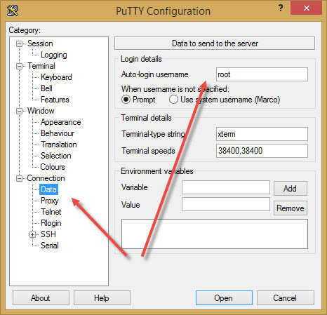

By the way, at this moment the kindle should still ask you on connection wich user you want to login as. And you would have to enter "root".
You can automate this too: just put "root" in text field: Connection - > Data -> Auto-login username and you're good to go.
When you'll press the "Open" button to connect to kindle, it will go straight to the prompt.
Don't forget to save your session after you add the "root" user as described and before opening the connection
Ruskie_it is offline   Reply With Quote
