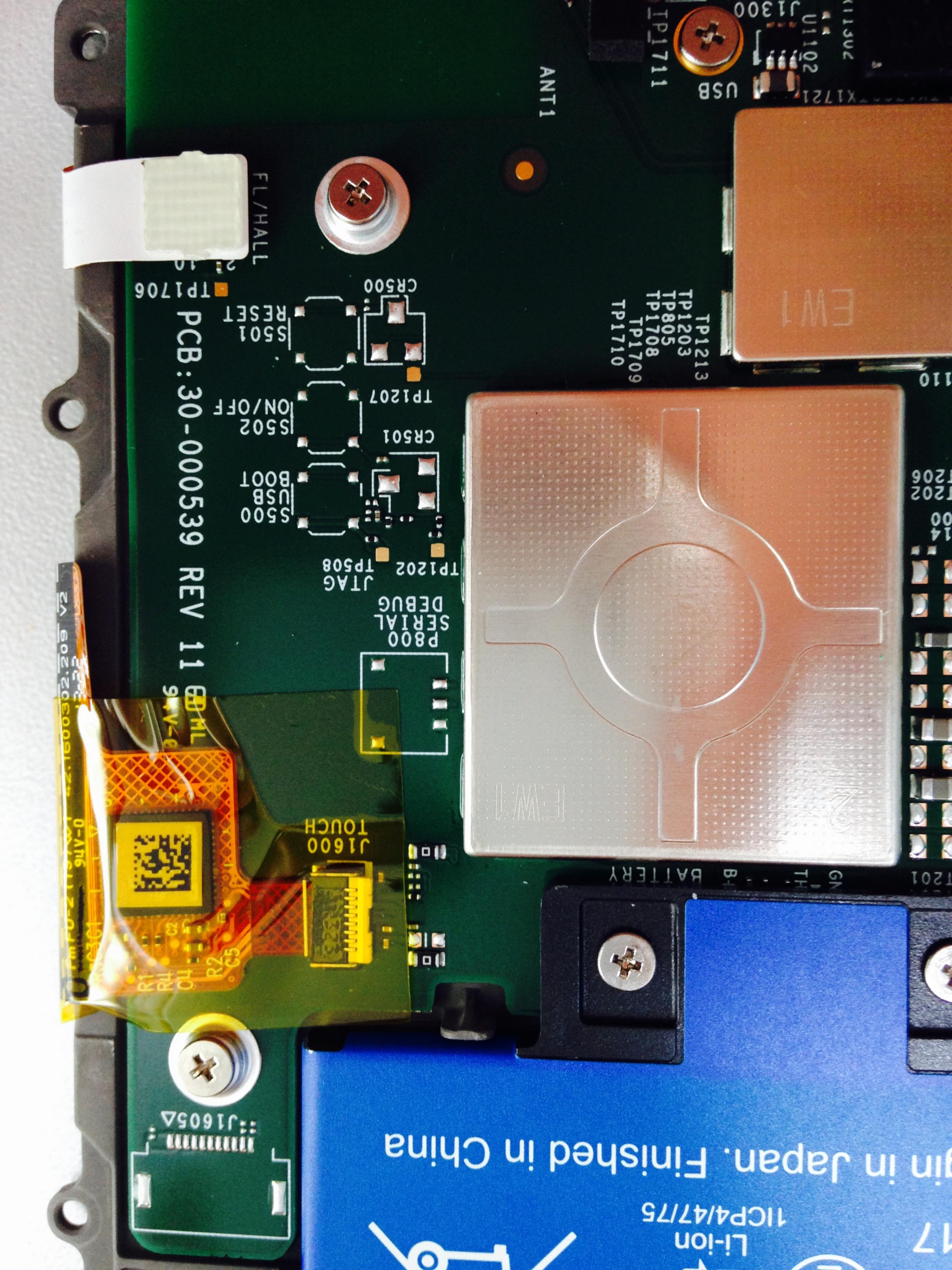

OK, bring on the fame and fortune!!
Clicky 1
Clicky 2
leedjc is offline   Reply With Quote

Teardown seems to be the same as PW1. Remove bezel and remove 11 screws to remove frame from back (noting the one behind the adhesive tape at the top!)
OK.
We will just assume its "PW1 style" until we learn differently.
Clicky 1
Clicky 2
Nice photo.
You struck gold on #1 - P800 - labeled "serial debug port".
The pad highest above the legend (rotate photo 180 degrees) is ground.
Which, if same as other Amazon products -
GND <--> GND of serial adaptor
Rx <--> Tx of 1.8v serial adaptor
Tx <--> Rx of 1.8v serial adaptor

Say what? You don't have the serial port connections up and running yet?
Heck, I waited 20 minutes.
In general:
Try to get into the recovery menu -
Export FAT partition -
Connect USB cable to computer -
Put Amazon PW2 update_*.bin in root of device -
Eject (or safely disconnect) Kindle -
Disconnect USB cable -
Reboot
That *should* install the non-demo firmware for you. (your done - put it together)

Done:
https://wiki.mobileread.com/wiki/K5_I...W2_Serial_Port
Note the last index entry on that page - it may be helpful at some point (if the "easy way" does not work).
