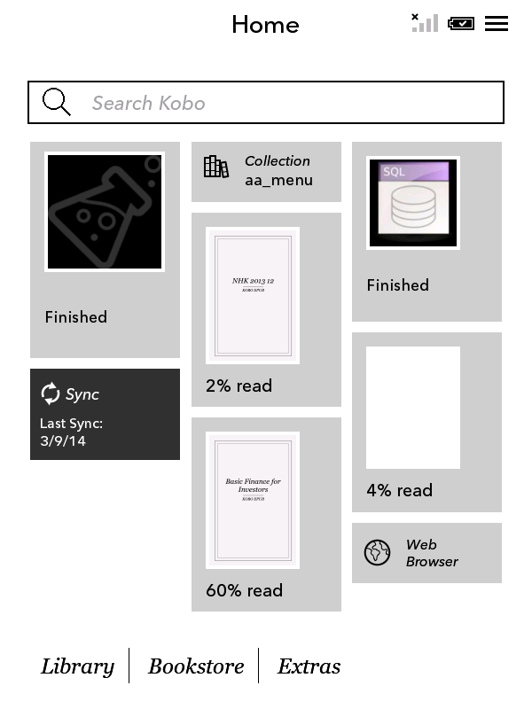

This is my first screenshot, using the script. Strangely, two files were created with 5 seconds of difference in the filename (they were identical). For the conversion I used 1014x768. The black pixels in the bottom right corner are invisible in the device (even under the bezel), and they make the "usable" screen 1014x758. Still, when setting the offsets for KSM (some posts above) I had to assume the screen height is 1024, not 1014.
(The "header" is coded in the book, the footer generated by nickel (patched).)
EDIT: And the device is actually full-color (I didn't see further double screenshots, so it must have been a glitch or a double-tap).

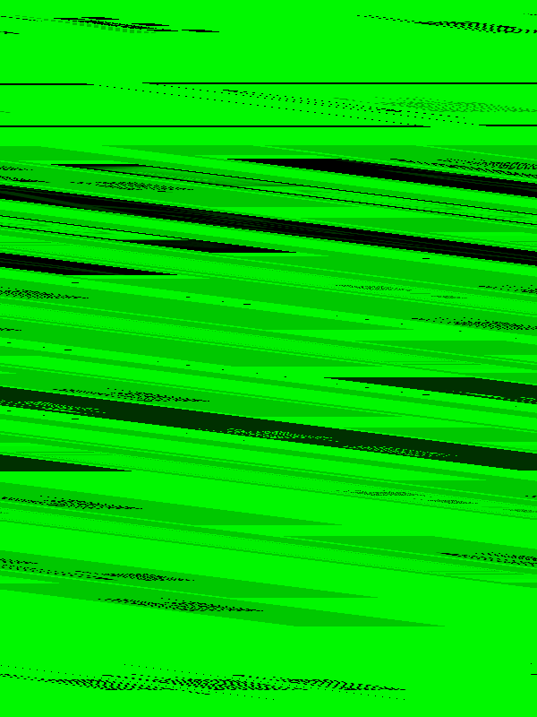

Thank you! It is nice that fbgrab outputs already a usable format. Monochrome is also nice for some purposes. The main problem is that nickel changes the fbsettings and this seems to be a problem that we might want to address. I myself do not know sufficiently about fb and graphic formats to do the necessary changes.
Without nickel running the settings are:

I attach two screenshots made with fbgrab, and two of the same screens with cat /dev/fb0 and conversion with ffmpeg.
I do not know about the other models, but on the Kobo Touch I need to convert the screenshots of Kobo Start Menu applications with -s 800x600; and the screenshots of nickel with -s 608x800, I have additionally to cut off the 8 pixel on the right border (-vf crop=600:800:0:0).

@tshering: Ha, it shouldn't take much to fix that . Part of it is similar to what I had to tweak for the K5 .
I can take a look at it if you both provide me with the output of fbgrab -v, and a raw fb0 dump in those two cases?

Quick question: are you rebuilding it or using a Kindle binary? Because I can't reproduce the 'green' issue w/ your dumps (at least on x86, will check on ARM later).

@tshering: Hmm. Strange, I couldn't reproduce it on ARM either. (EDIT: Which binary did you use? The K5 one should be the closest one, although softfp, not that it matters that much here).
[EDIT²: Meh, my bad, I only put a single binary in there. Keep the previous comment in mind for when I'll update the package, though].
Well, the good news is, it was slightly off in every cases anyway, so I ended up porting KOReader's maths (again ;p).
I'm making sure that I didn't break anything in Kindle-land, and I'll update the post .
