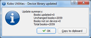

Odd series names
Just wondering if anyone else is noticing an oddity where books that are not in a series will have a single character show in the series field. I've noticed this a couple of times when I've modified several books and did an update metadata on the whole library. Instead of getting the result I expected with just a few books showing as being updated, I get several hundred books shown as being updated.
In the three images I've attached, the first run is after modifying the series data on 5 books and just being lazy and updating the entire library. The second run was after disconnecting and reconnecting my Kobo with no changes in the series data, the third run is after modifying the series data on two more books.
In between the first and second run, I looked at the library view on the Kobo and in the first 5 pages, I found several books belonging to a series called 'c' with no series number. When I looked again, after the third run, those single character series were gone.
Regards,
David

I think the first one is the easy one to explain. What options do you have set on the update metadata dialog? The firmware doesn't read the publisher, published date or ISBN from sideloaded books. If you have these selected, there could be a lot of books to be updated. Plus there are any other changes to the books metadata that gets updated.
For the rest, do you use a plugboard to put the series info in the title? There was a bug in matching books between the device and calibre library if plugboards were used and there was a book on the device whose filename didn't match the plugboard. In this case, the series was set to the first letter of the filename. I thought I had fixed this, but maybe it has come up again. I'll have a look.
Hmmm... I do have the Publisher checkbox selected which might be causing the issue. I'll try deselecting that check box and see how it behaves. ISBN and published date are already not selected.

Metadata update oddity
I've reduced the metadata to title, author and series/index and still get the same 405 books getting updated.
Regards,
David
