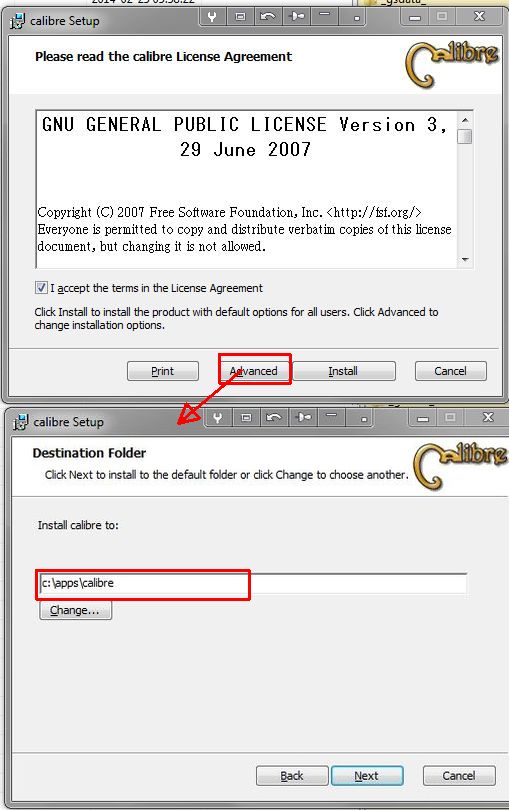

can't install calibre to path of my choice
Latest calibre [1.25] is not letting me install it to c:\apps\calibre
I have tried to change path multiple times but it ends up getting installed in "c:\program files\calibre2" everytime, no matter what I do
Is it just me ?
Thanks

betavita : Possibly - I just installed the 32bit at c:\apps\calibre with no dramas (uninstalled it too, again no drama)
I assume you are using the available dialogue and not some back door kludge - if latter probably best not, use the front door - see attachment

I just used shift right click and selected install as different user and logged in as admin. now i have it in c:\apps\calibre
In 1.24 I could see the shield on calibre installer and also on advanced option when running installer but I can't see those options any more.
