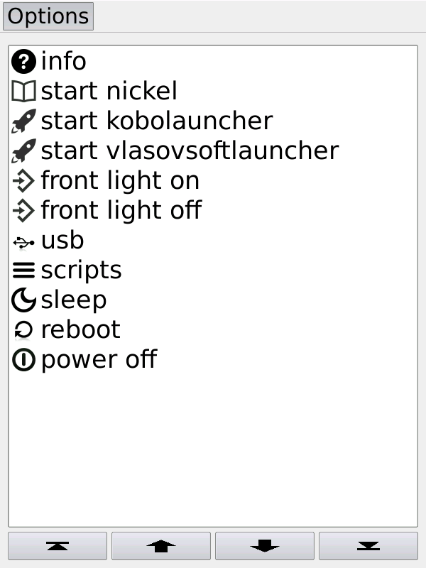

I added front light on/off to the main menu. I set the level of "front light on" to "4". If you want to change the level, for example to 6, add to the usersettings.txt
frontlightOnLevel=6
Simply put the KoboRoot.tgz into .kobo.
Edit: I should mention that with this version, there is also no need to reinsert the external SD in order to be recognized by the device.
