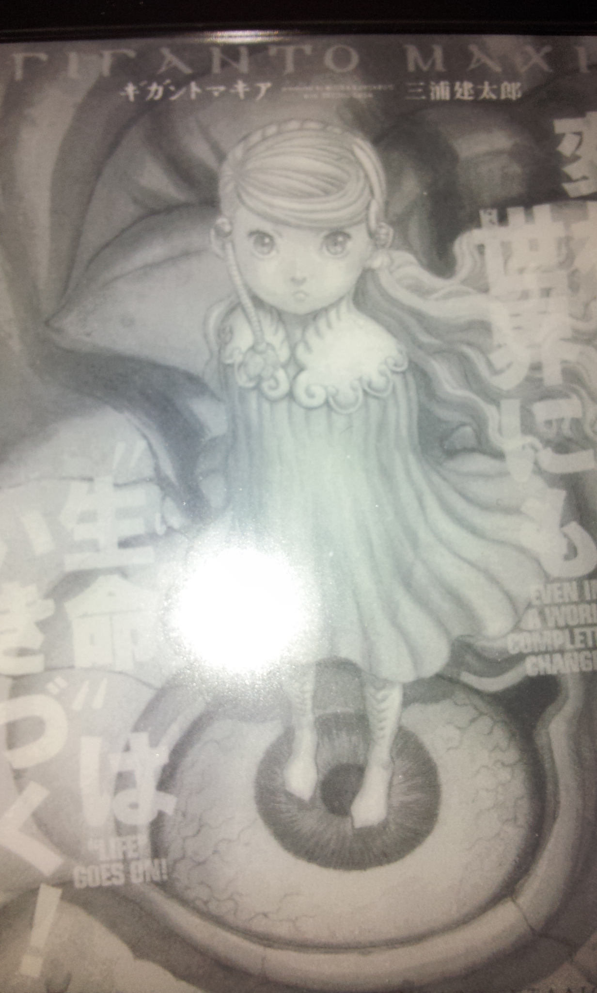

Old 12-21-2013, 08:18 PM   #910
gong
gong has a complete set of Star Wars action figures.gong has a complete set of Star Wars action figures.gong has a complete set of Star Wars action figures.gong has a complete set of Star Wars action figures.
gong's Avatar
Posts: 47
Karma: 384
Join Date: Nov 2013
Device: Kobo Mini (f/w 3.4.1) + Aura (f/w 3.12.1)
Hello, here is another example of the "gray" bug. The left picture is from build 644 and the right one from 701. I have tried several builds until I found the bug has been occuring since build 656.
ID:	116996   Click image for larger version
gong is offline   Reply With Quote
Old 12-21-2013, 09:48 PM   #911
Ken Maltby
Ken Maltby's Avatar
Posts: 4,466
Karma: 6900052
Join Date: Dec 2009
Location: The Heart of Texas
That looks right for my experience with my AuraHD as well. I guess there is some different C routine called with the FFI than was used with the straight LuaJIT external calls. In any case I hope they can find some good rendering code to go with the FFI approach.
Luck;
Ken
