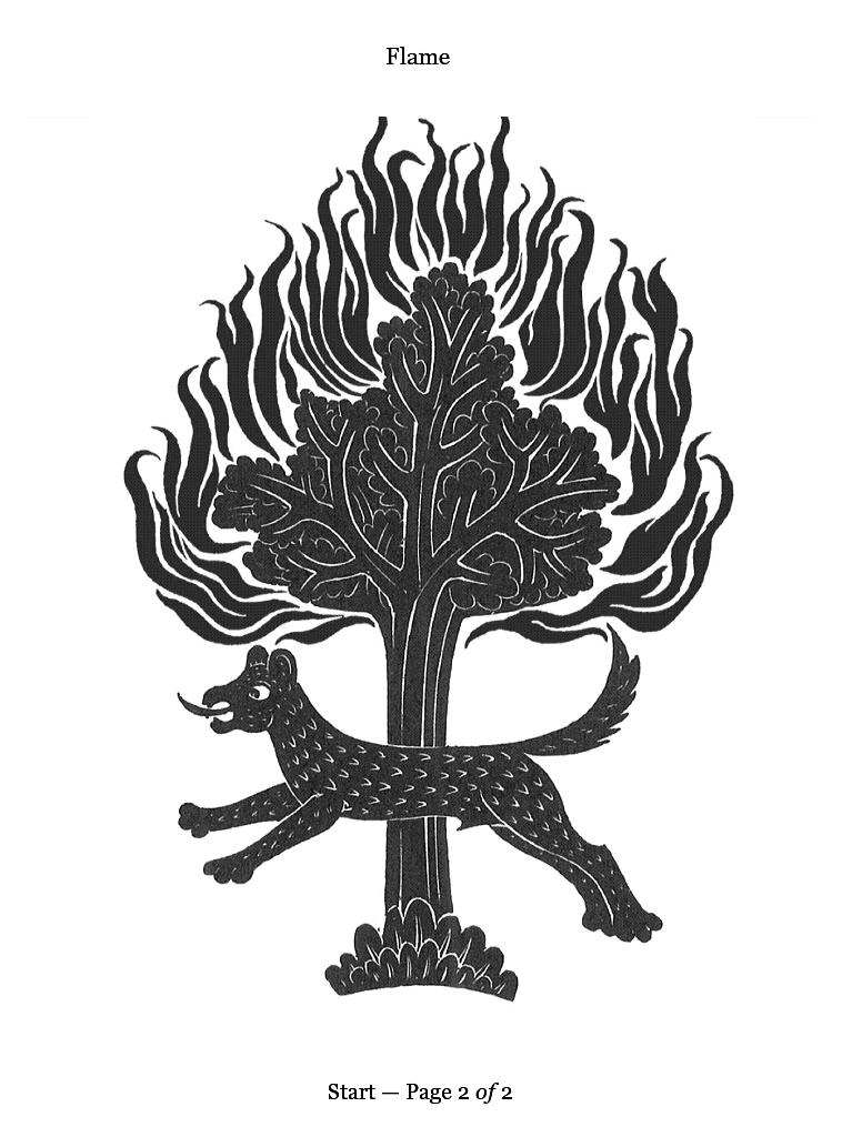

I've fixed all the images to fit in portrait mode, but they are still broken in landscape if they are too big to fit in one page or they are at the bottom...
I've attached an image that has these properties:
width: 553px;
max-width: 100%;
height: auto;
It's good in portrait mode but it's broken in landscape.

OK; I will try to fix that in order that you can see it good in both modes, portrait and landscape.

Hi Liliann;
Well, I don't have Kobo so I can't say if this aproximation works but in ADE looks fine. Tell me how does it work in Kobo the ePub I attached below.
Regards
Rubén
Old 12-13-2013, 04:31 PM   #27
Liliann
Liliann began at the beginning.
Posts: 17
Join Date: Dec 2013
Hi Liliann;
Regards
Rubén
Thanks Rubén but not in Kobo
neither in landscape mode...

Well, let's continue trying
Do the following:
Open the ePub that I uploaded in my previous post with Sigil and, in the stylesheet.css file write:
.TableCell {
  display: table-cell;
Now, enable the Section0001.xhtml file and in the Code View, where you see:
<div>
    <svg xmlns="http://www.w3.org/2000/svg" height="100%" preserveAspectRatio="xMidYMid meet" version="1.1" viewBox="0 0 1153 1577" width="100%" xmlns:xlink="http://www.w3.org/1999/xlink">
      <image class="TableCell" height="1577" width="1153" xlink:href="../Images/flame.jpeg"></image>
    </svg>
</div>
write:
<div class="TableCell">
    </svg>
</div>
Save all and watch how does it look in Kobo. If doesn't work, then try:
<div>
    </svg>
</div>
Maybe this time we are in luck
Old 12-14-2013, 12:18 AM   #29
davidfor
Posts: 24,905
Karma: 47303824
Location: Sydney, Australia
What are you actually using to view this? I assumed a Kobo e-ink device, but, I just noticed that the photos showed colour on the screen. Are you using a Vox, an Arc or the Kobo app on an Android or iOS device?
And for the record, attached are screenshots taken on a Kobo Glo with the latest firmware. This is with RbnJrg epub. "flame_epub.png" is of the epub which uses the Adobe based reader. "flame_kepub.png" is loaded as a kepub which uses the ACCESS based reader.

I'm testing it on Kobo Arc.
Rubén, with your first solution there is only one page and the image is missing in a mysterious way...the second one does the same.
Is there any way to disable the landscape mode only on Kobo?
