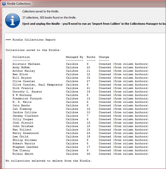

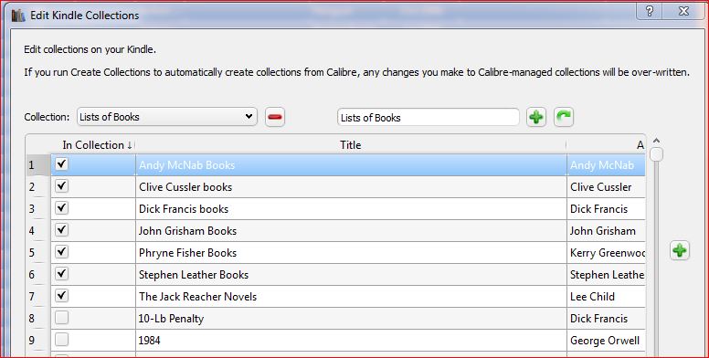

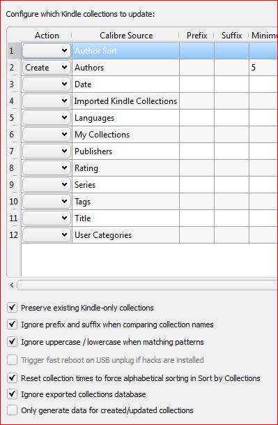

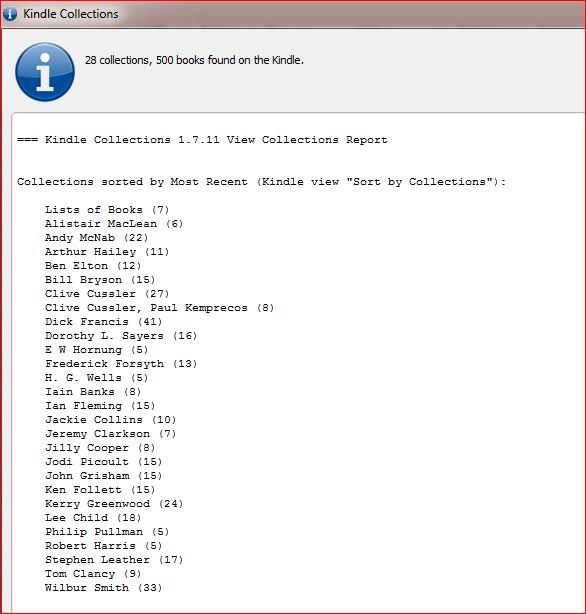

Hi all - sorry if this is a really dumb question. I've got a jailbroken Kindle Touch, Collections Manager running on the Kindle and the Collections plugin running in Calibre. What I want to do is use the 'Create' function to generate most of my collections by author, but use the 'Manual' function to create some additional collections.
The first screen shot (CM1) shows my settings and options for the Create function. The second screen shot (CM2) Shows my manual selection just before clicking the 'save' button. The third screen shot (CM3 View Report) shows the results from 'View Report', where the manually created collection appears as the first in the list. The fourth screen shot is the detail of the collections created by the 'Save To Kindle' function - and the manually created collection is not there. After running Collection Manager's import on the Kindle Touch, the manual collection does not appear on the Kindle although all the rest do.
Does the warning (on attachment 2) about 'Create' overwriting Calibre-managed collections really mean that manual collections will be ignored so I can't do what I want to do?
I am hoping this might be as simple as a wrong tick in a box somewhere, but I'd appreciate any help you folks can give. Just a link to the post with the answer would be fine!

@viragored: Yup, the warning is accurate, you'll have to do it the other way around.
(Create => Manual), while making sure that you whitelist those collections you don't want Create to touch (what would be on the right part of the lower panel of the settings, cropped out in your first attachment) so that you don't lose your manual changes the next time you run Create..

Thanks @NiLuJe, I hadn't got my head round the whitelisting field. All my collections are now safely on the Kindle Touch
