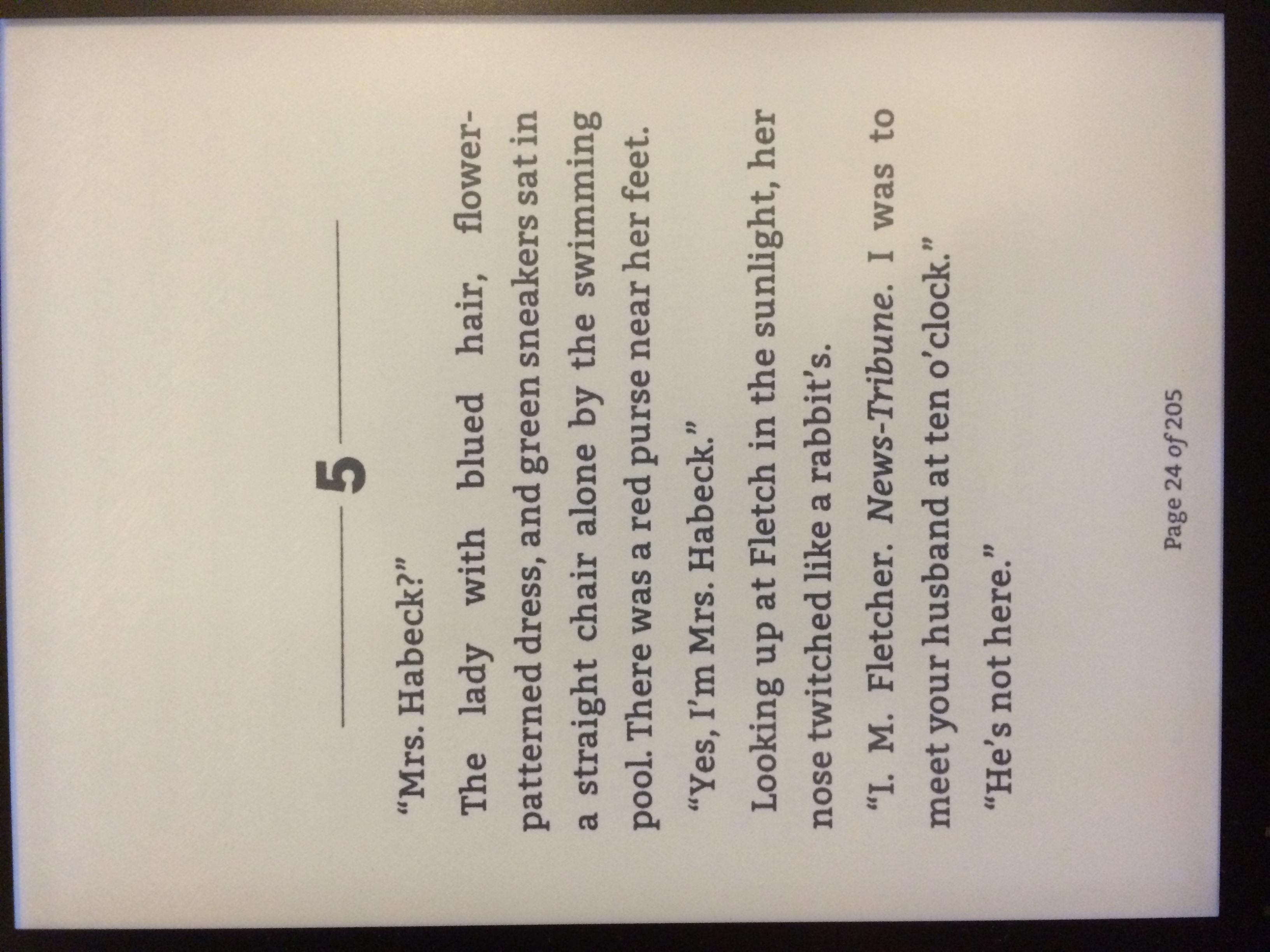

I thought I'd get in on this game! I took the open source font, Bitter, and darkened it a bit for the e-ink screen. I'm kind of in love with it right now, and I thought others might want to try it. I'm finding it a nice alternative to Caecilia (I like how it's less wide).
I've tested it on the Kobo Aura (6"), and it looks pretty sharp. Give it a whirl!

... I took the open source font, Bitter, and darkened it a bit for the e-ink screen.
Nice work, Donnie! I really like this font. But somehow you must have forgotten to darken the umlaut "ö".
I know, in English you don't need "ö" very often, but in German it appears quite often. Maybe you can darken the "ö" and refresh the zip file? I would be very grateful

Well, it turns out, that the Italic-font is to blame. I fixed the "ö" and saved the font as TrueType. Everything is ok now. Thanks again, Donnie!
