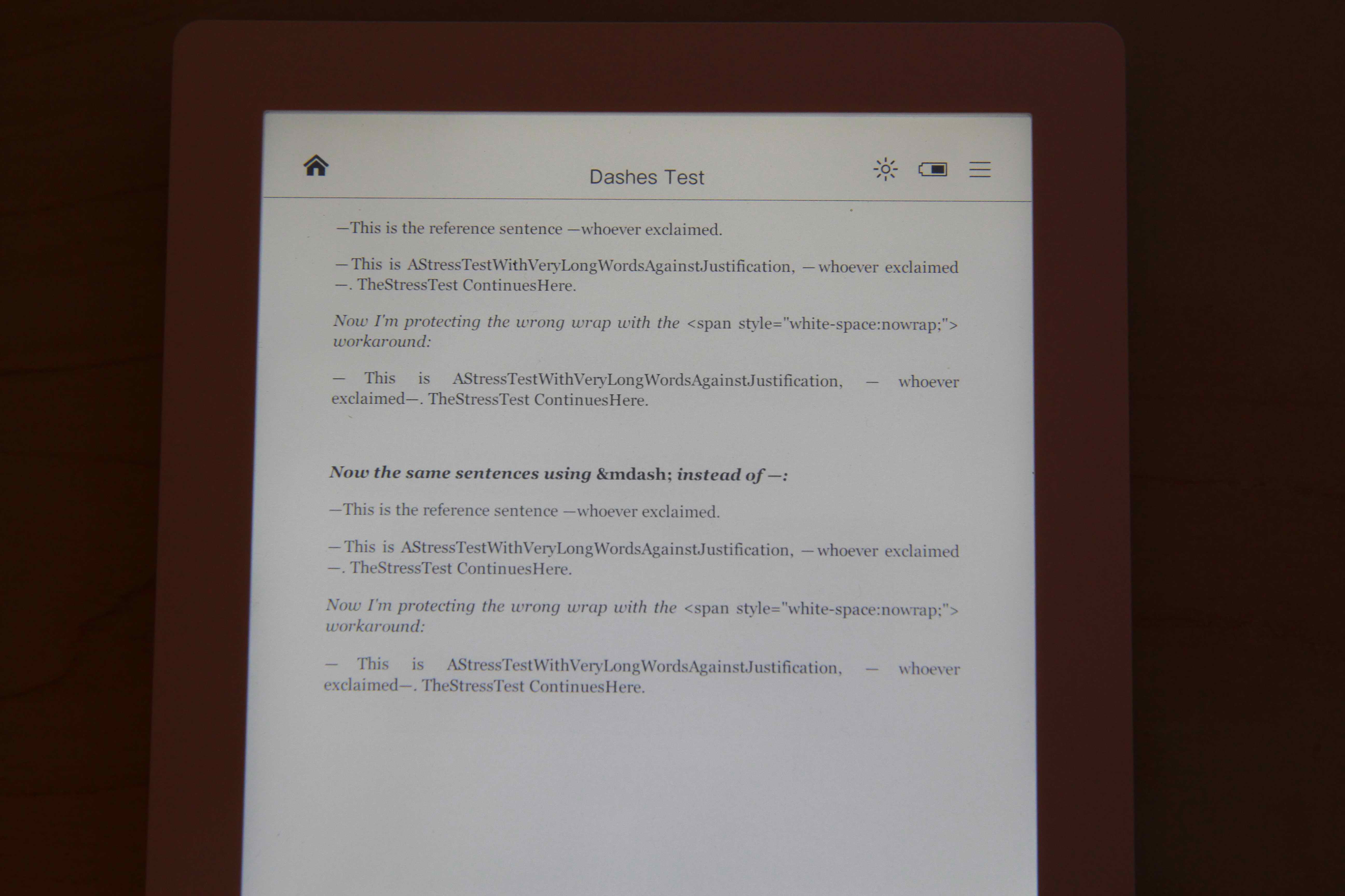

Originally Posted by jgoguen View Post
Can you PM me a link to a freely-downloadable Spanish book that demonstrates this problem? Even better if you can point to what chapter and page it happens on.
It's easier than that. Here you have a pretty simple epub to play around with it. (Thanks, Sigil ).
Or if you want to build it yourself, its html code is just this:
<?xml version="1.0" encoding="utf-8" standalone="no"?>
<!DOCTYPE html PUBLIC "-//W3C//DTD XHTML 1.1//EN"
  "http://www.w3.org/TR/xhtml11/DTD/xhtml11.dtd">
<html xmlns="http://www.w3.org/1999/xhtml">
<head>
  <title>Dashes Test</title>
</head>
<body style="text-align:justify;">
  <p>—This is the reference sentence —whoever exclaimed.</p>
  <p>—This is AStressTestWithVeryLongWordsAgainstJustification, —whoever exclaimed—. TheStressTest ContinuesHere.</p>
  <p><i>Now I'm protecting the wrong wrap with the</i> &lt;span style="white-space:nowrap;"&gt; <i>workaround:</i></p>
  <p>—This is AStressTestWithVeryLongWordsAgainstJustification, <span style="white-space:nowrap">—whoever</span> <span style="white-space:nowrap">exclaimed—.</span> TheStressTest ContinuesHere.</p>
  <p>&nbsp;</p>
  <p><b><i>Now the same sentences using</i> &amp;mdash; <i>instead of —:</i></b></p>
  <p>&mdash;This is the reference sentence &mdash;whoever exclaimed.</p>
  <p>&mdash;This is AStressTestWithVeryLongWordsAgainstJustification, &mdash;whoever exclaimed&mdash;. TheStressTest ContinuesHere.</p>
  <p>&mdash;This is AStressTestWithVeryLongWordsAgainstJustification, <span style="white-space:nowrap">&mdash;whoever</span> <span style="white-space:nowrap">exclaimed&mdash;.</span> TheStressTest ContinuesHere.</p>
</body>
</html>
Play with it as much as you want.
I also upload a screenshot from Calibre e-book viewer which shows the right rendering and how the span trick fixes the wrong sentence wrap.
Edited----

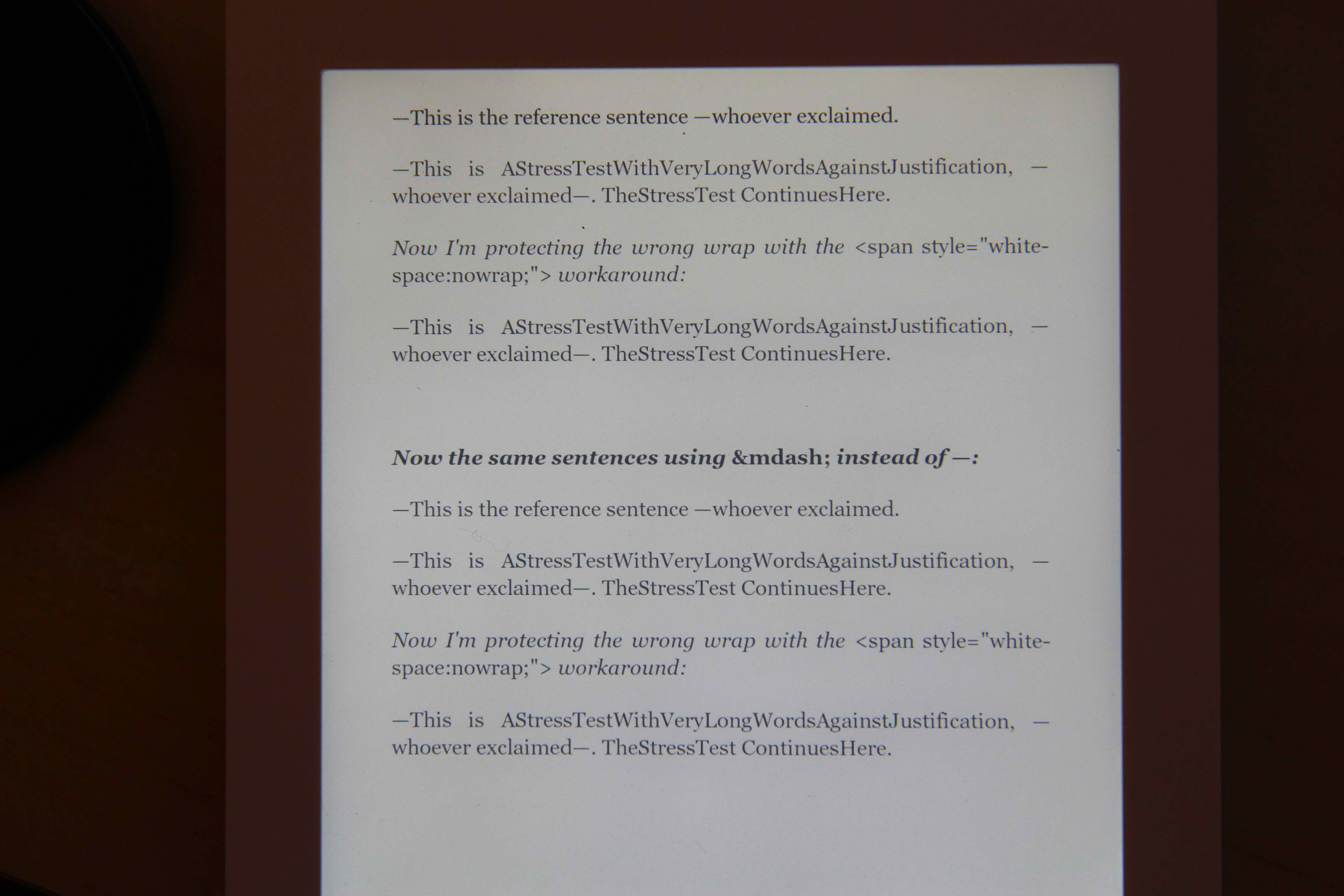

Hey, what the hell! Here you have a picture directly taken from my Aura HD. In the second sentence the problem is already shown but the third one is just crazy. (The bigger spaces in the third sentence are caused because the span trick doesn't allow "exclaimed" and its "—" being in different lines).
Playing with margins and font sizes you can make it more or less obvious.
OTOH. Is it possible to take a screenshot directly from the Kobo Aura HD with some trick? (In my old PRS-650, you need PRS+ modified firmware to get it)
IMPORTANT EDIT - NEW BUG!!!! -------
Look at the new image (IMG_0241.jpg) which uses epub renderer NOT kepub one:
<span style="white-space:nowrap;"> has stopped working!!!!

Old 10-31-2013, 08:52 PM   #302

Originally Posted by Lucas Malor View Post
@arspr: your bugs are similar to this one. Do you know if they happens with other special characters too?
It's similar and it's not.
The problem there is that html tags are breaking the link between punctuation marks and their partner word. I don't know if this is a bug or just how html is supposed to work. I cannot assure that that behaviour is wrong (even if it seems weird).
You should test if you suffer the issue in, let's say, <i>what</i>ever (which should be displayed as whatever). I bet that the renderer is also going to wrap in the middle of the word when necessary.
It would be similar to the trick with white-space:nowrap;. I mean, a dash is probably a "possible wrap point" in html standard. So the problem is not in the renderer (which uses html rules) but in the use that Spanish makes of dashes within dialogues. Because of that, I don't claim that wrapping between dashes and their partner word is a bug. I suppose that it is just a conflict between Spanish language rules and html ones (built upon English).
But the problem in kepub renderer is that it is breaking "—whatever—" in three different words even in the middle of a line. And I haven't seen this behaviour in any other place but in kepub renderer... And in addition, there doesn't seem to be any way to avoid or modify that behaviour. (While in your issue you can also use the white-space:nowrap; fix).
And, in the second bug, the epub renderer is not following the explicitly forbidden wrap through the white-space property...

Old 11-04-2013, 06:32 PM   #313
arspr
Dead account. Bye
arspr ought to be getting tired of karma fortunes by now.arspr ought to be getting tired of karma fortunes by now.arspr ought to be getting tired of karma fortunes by now.arspr ought to be getting tired of karma fortunes by now.arspr ought to be getting tired of karma fortunes by now.arspr ought to be getting tired of karma fortunes by now.arspr ought to be getting tired of karma fortunes by now.arspr ought to be getting tired of karma fortunes by now.arspr ought to be getting tired of karma fortunes by now.arspr ought to be getting tired of karma fortunes by now.arspr ought to be getting tired of karma fortunes by now.
Posts: 587
Karma: 668244
Join Date: Mar 2011
As workaround, try:
white-space: nowrap !important;
word-wrap: normal !important;
text-wrap: none !important;
text-justify: inter-word !important;
It doesn't work. On the former epub I've added text-justify: inter-word to body and the rest to the "protecting" spans and both issues remain the same:
  • KEPUB renderer (called ACCESS?) has a horrible space between dashes and words.
  • EPUB renderer (RMSDK) has broken the white-span trick...
(And by the way I've discovered a completely different one. See next post).
arspr is offline   Reply With Quote
