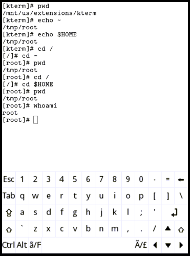

was able to make it work by running the mkdir and cp commands by hand in kterm..
those 3 tiny buttons now have unclipped characters..
but something weird happening..
i had earlier followed some post here to change home from /tmp/root to /home/root
now running
echo $HOME
or
echo ~
still gives
/tmp/root
as the output..
but.. doing a
mntroot ro
or a
mntroot rw
is not affecting /tmp/root.. it's affecting /home/root..
so.. i did:
  1. Code:
    mntroot rw
  2. Code:
    mkdir -p /home/root/.config/galculator
  3. Code:
    cp /mnt/us/extensions/galculator/.config/galculator/galculator.conf /home/root/.config/galculator/galculator.conf
which works.. but should i leave root fs in rw mode..
would like our experts' explanation for above behaviour..
now running
echo $HOME
or
echo ~
still gives
/tmp/root
as the output..
but.. doing a
mntroot ro
or a
mntroot rw
so.. i did:
  1. Code:
    mntroot rw
  2. Code:
  3. Code:

The answer to all your questions lies above, namely in what is mounted where. /tmp is just a symlink to /var/tmp, and /var is a tmpfs, so it will disappear after shutdown.
/home would be on the root partition, and thus read-only in normal use. And yes, I agree that it's a bad idea to leave root mounted rw for normal use.
You have two options here: use a home directory on the USB partition (/mnt/us), or in /var/local. The advantage of the former is that you can edit files via USB, the advantage of the latter is that it's a real filesystem, not FAT32. I suggest to go for /var/local/home/root, or /var/local/root, or whatever you please.

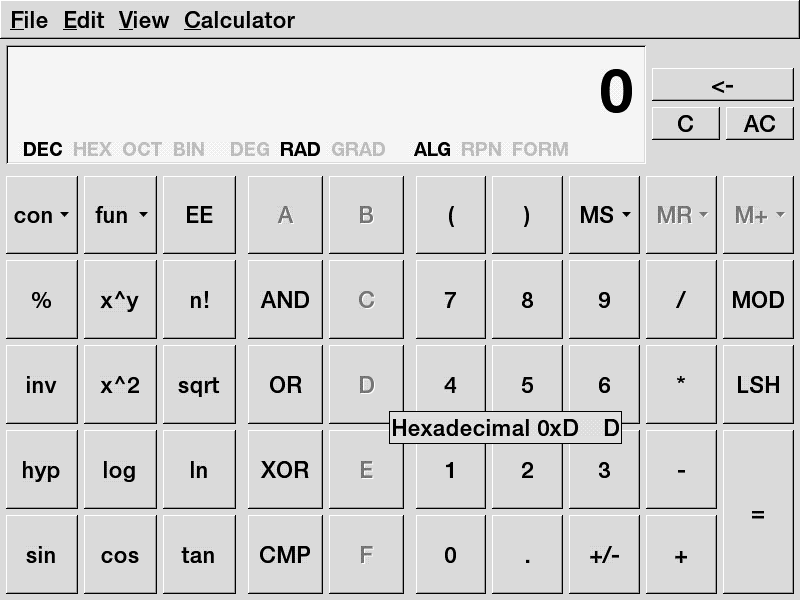

By the way, I think it looks better in landscape on KT
baf is offline   Reply With Quote

well.. baf seems to have found a simple solution..
but thanks to ixtab for explaining..
i need to fix my home location..
need to read and understand in detail..
am still puzzled by why echo $HOME and cp to ~ still recognise /tmp/root as home.. whereas mntroot and galculator itself consider /home/root..
nasser is offline   Reply With Quote
looks great..
how to enable landscape mode..? on..PW?

Originally Posted by ixtab View Post
As baf said. Your current shell instance still uses the old values. Logging out and back in should fix that.
i've done a restart more than once after doing the home location fiddle.. surely that should be enough..?
..and i go to the kindle CLI either through kterm or ssh.. in both, i come out by typing exit.. or in the case of kterm sometimes, by using the 2 finger menu>quit option.. don't these count as a "logout"..?
will check again..

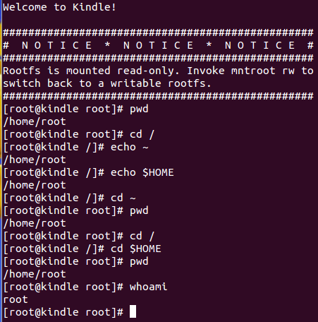

Hmmm... I don't know. For me, it works as it should:
$ ssh root@kindle
[root@kindle root]# mntroot rw
system: I mntroot:def:Making root filesystem writeable
[root@kindle root]# grep ^root /etc/passwd
root:x:0:0:root:/tmp/root:/bin/sh
[root@kindle root]# sed -i -e 's/\/tmp\/root/\/var\/tmp\/root/' /etc/passwd
root:x:0:0:root:/var/tmp/root:/bin/sh
[root@kindle root]# mntroot ro
system: I mntroot:def:Making root filesystem read-only
[root@kindle root]# echo $HOME
/tmp/root
[root@kindle root]# ^D
Connection to kindle closed.
$ ssh root@kindle
/var/tmp/root
ixtab is offline   Reply With Quote
Old 09-21-2013, 03:54 AM   #45
nasser
nasser ought to be getting tired of karma fortunes by now.nasser ought to be getting tired of karma fortunes by now.nasser ought to be getting tired of karma fortunes by now.nasser ought to be getting tired of karma fortunes by now.nasser ought to be getting tired of karma fortunes by now.nasser ought to be getting tired of karma fortunes by now.nasser ought to be getting tired of karma fortunes by now.nasser ought to be getting tired of karma fortunes by now.nasser ought to be getting tired of karma fortunes by now.nasser ought to be getting tired of karma fortunes by now.nasser ought to be getting tired of karma fortunes by now.
nasser's Avatar
Posts: 477
Karma: 445678
Device: Too many..
there seems to be a difference between logging in through ssh and "logging in" through kterm.. see screenshots..
ssh recognises the "new" home at /home/root..
while the kterm session is still hung up on /tmp/root..
