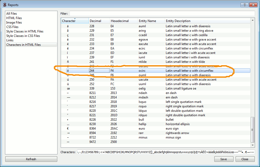

Old 08-14-2013, 09:16 PM   #42
Tex2002ans
Posts: 2,306
Karma: 13057279
Join Date: Jul 2012
Device: Kobo Forma, Nook
Feature Requests:
Tools - Reports - Characters in HTML Files.
Currently, this report correctly goes from HTML entity names/decimal/hexadecimal and actual characters -> the report. What it does not do, is go the opposite.
When double clicking on a character in the report, it brings you to the next instance of only the actual character, but it does not find named/decimal/hexadecimal instances. I attached an image showing how clicking on 'ô' does not lead to "ô" in the HTML file.
ID:	109396Click image for larger version
Tools - Reports - Links
While clicking on a link in this report, you would expect it to lead you directly to the location. Instead, it seems to only open up the HTML file in which the link occurs. From there, you have to manually search for the link.
Entity -> Character + Character -> Entity
Also, a nice thing to have added might be a setting for Sigil to automatically go from entity (names/decimal/hexadecimal) -> character, character -> entity (names/decimal/hexadecimal).... currently, I am doing this the slow way by mass running a huge batch of Saved Searches.

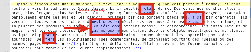

Old 08-15-2013, 01:28 AM   #43
roger64
Posts: 2,625
Karma: 3120635
Device: Kindle PW3 (wifi)
Hi
@Tex2002ans
To my shame, I never used the "report" feature of Sigil and it's indeed a nice one. You have trouble displaying French (mostly) characters - à, é, è, ô, etc.
I show you part of my report (figure one), how ô is displayed in
code view (arrow as an example in fig 2) but also é, è, à, and the declaration I use for every xhtml file (Note).
I make no use of a complicated translation table for entities. It all goes smoothly and displays conveniently all French characters. Maybe this could help.
Note:
<?xml version="1.0" encoding="UTF-8" standalone="no" ?><!DOCTYPE html PUBLIC "-//W3C//DTD XHTML 1.1//EN" "http://www.w3.org/TR/xhtml11/DTD/xhtml11.dtd"><html xmlns="http://www.w3.org/1999/xhtml" xml:lang="fr-FR">
ID:	109405   Click image for larger version
Name:	accent circonflexe.png
Old 08-15-2013, 02:29 AM   #44
Tex2002ans
Posts: 2,306
Karma: 13057279
Join Date: Jul 2012
Yeah the Reports are great! I use the Character Report at least once per EPUB just to make sure I can catch any anamolies (I do a lot of PDF -> OCR -> EPUB). Most of the time, my source already has the actual characters.... I rarely use the entity names, so I never ran into this problem.
Over the past week and a half I have been importing 15 years worth of articles (~6500) into Sigil, and cleaning them all up to prepare a few gigantic yearly EPUB releases (~300 articles per EPUB). In this case, the original HTML used entity names. I wanted to do some cleanup in Sigil, then do code comparison to the originals (this is why I want entities there), then I want to easily be able to swap back to characters before proofreading and releasing the EPUB (actual characters allow me to read the code much easier, and be able to catch more mistakes).
I rarely use the Link Report, but in this case, there are THOUSANDS of links pointing everywhere on the internet. The Link Report allows me to easily spot links which do not belong in the EPUB, footnotes I have not normalized (over 15 years... you can imagine all the different tools/programs that were used to generate these things).
The Class Reports allow me to catch outliers in the code itself (a weird class name that was only used once in all the articles, etc.).
I will definitely be using it more in the future, it is really helping me consolidate code. HUGE time savers.
Looks to me like that XML declaration is just setting the language of the file to French. I believe Sigil uses the XML declaration at the top of the file to do some auto cleanup of entities. I know I read the logic behind the Sigil auto-clean of entities was somewhere on these forums (maybe meme or user_none in one of the older Sigil release topics?).
And I just thought of another slight tweak on the Entity -> Character, Character -> Entity request. Perhaps it can be added to the Right Click Menu -> Reformat HTML. So you will get 4 extra options there:
Characters to Entities
Characters to Entities - All HTML files
Entities to Characters
Entities to Characters - All HTML files

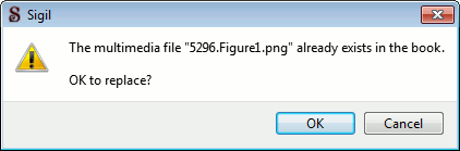

Old 08-15-2013, 06:25 PM   #45
Tex2002ans
Posts: 2,306
Karma: 13057279
Join Date: Jul 2012
Feature Requests:
Duplicate Images Yes/No to All:
When Adding Images which already exist, you get this dialog:
When adding tens/hundreds of potential duplicate files, you have to press "ok/cancel" tens/hundreds of times. It would be nice if there was a "Yes to All" and "No to All" added.
Duplicate HTML files Overwrite:
When adding duplicate XHTML files, you get this dialog:
You have zero choice in what you want to do (in this case I want to overwrite, but I just have to press "ok"). This dialog also falls into having to click "ok" tens/hundreds of times. Most of the time I just kill Sigil, instead of dealing with hurting my mouse finger.
This dialog can also benefit from an "Overwrite", "Overwrite All", "Ok" choice. Or maybe it can complain and in one shot just give a list of files it cannot insert.
Currently, I either:
1. Open the EPUB in 7-zip, overwrite the XHTML files manually, and then reopen the EPUB in Sigil and continue working.
2. Use Sigil to mass delete all the XHTML, then add all the XHTML again using Sigil.

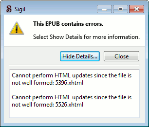

Easier Recognition of Not Well Formed Files
When you open up an EPUB with malformed files, and tell Sigil to not automatically clean the file, you get this dialog:
Would be nice if somehow it was possible to get a dialog such as this one, without having to exit/reenter Sigil. Also, it would be nice if this dialog would alphabetically sort the malformed files. Currently, it seems like they are just randomly placed there:
5296.xhtml, 5357.xhtml, 5100.xhtml, 5050.xhtml, 5400.xhtml, ...

HTML File Report Problem (?)
Also, this column in the HTML Files Report seems to be me to be worthless. You cannot get into Reports unless the files are all well formed.
