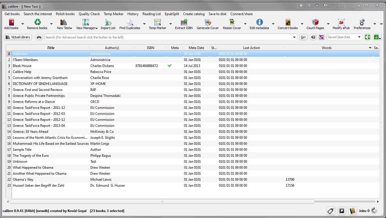

I thought that what you meant, I use the View Manager so your term confused me, I call the Tag Browser and Book Details areas - panels; the Metadata Edit area a modal dialogue box. And what's in between the Tag Browser and Book Details panels, I call the Book List or the Spreadsheet.
I have a custom column: Edit EPUB(#edited), Aligned Left
All dates look normal .
Have you tried to change the date display format?
Attached has Meta Date as dd MMM yyyy (the default format) - as you can see - still not empty
Can you post image of what you see in Edit EPUB after you have set to the value to Undefined - either via the Clear Edit EPUB button in Edit Metadata or via pressing he minus key - in an Edit EPUB cell.
Or just add an empty book - what's in Edit EPUB cell - empty or 1st Jan 0101.
Member davidfor is reporting the same issue - maybe its a for Aussie's only bug Or its a 32bit v 64bit or install v portable issue - I refuse to contemplate that it might be a Windows XP versus 7 issue.

@BetterRed && davidfor: about dates. What do you see when you hover the mouse pointer over a should-be-empty date value in the spreadsheet view? It should be 101-01-01T01:00:00.
No I am seeing "101-01-01T10:00:00". When I go back to the old DB, it shows as "101-01-01T00:00:00". That makes me think time zone issues.
I think you are right about timezones, but that leaves me with a different problem -- why. Looking at the code, it compares the year/month/day in UTC, so the timezone shouldn't play a role. And of course, it doesn't break for me.
As you can run from source, could you put a print statement into gui2/library/delegates.py after line 94 (in DateDelegate)? Something like
print(d.year, d.month, d.day)
What I am looking for is evidence that the date is in localtime and somewhere the date is being adjusted across midnight.
Thanks for your help!
olddb 101-01-01 T00:00:00 Display <empty cell>
newdb 101-01-01 T10:00:00 Display 0101 01 01 09 00 00
I'm Zulu +10, I suspect davidfor is in same timezone
Does Kovid see T05 30 ?
Old 07-29-2013, 04:06 AM   #40
Posts: 45,916
Karma: 29228280
@chaley: I fixed the custom column date display bug, it was a timezone issue, the old code did a direct comparison of dates, causing the problem, see https://github.com/kovidgoyal/calibr...8cc08391bde623
I should have posted about it earlier, but I had to leave ina hurry and I forgot.
