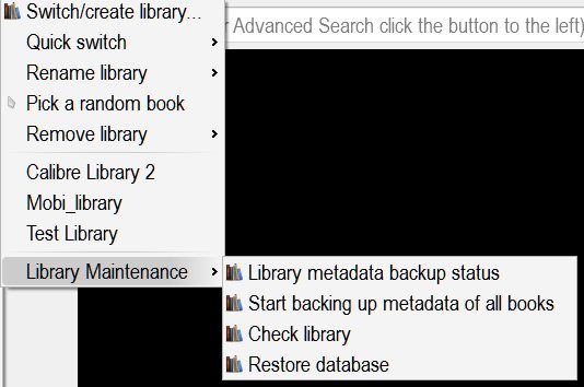

What version of calibre are you running? What OS are you using. You should easily see the menu without jumping through any hoops. I attached the menu you will see with the latest version of calibre.

I'm using the latest version (0.9.16) - it updates almost every time I run it! I'm on Windows 7 64 bit (I have both 32 and 64 bit Calibre installed)
I have nothing like the number of options you do, I have two items (as above). I don't have a regular menu, just big buttons with chevrons, even when I hit the ALT key.

Do you have a device connected or do you have Connect to Folder active? In that case, the Library button behaves exactly as you state (i.e. the database maintenance functions are unavailable, and the button does not show the number of books).
Excellent observation.
@foomonger ignore my 2 suggestions below until you disconnect any device connected to your computer and look for the Library maintenance menu again.
That was it! I had my mate's Kindle attached. When I unplug it, the menu buttons transform back. It's still not nearly as comprehensive as DoctorOhh's menu, but the one I need is there. Cheers!
It is not the same only because I have used the switch library feature more than once. If you ever do the same, those other options will pop up using a history file of what libraries you have used in the past.
