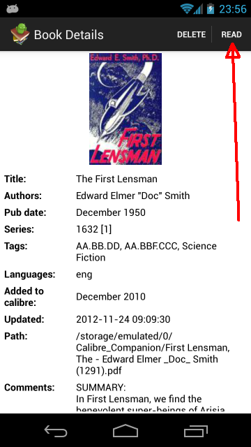

The read button is on the action bar at the top right of the screen. It is next to the delete button. See the screen capture below.
You can also read by long-pressing on a book.
And yes, you must install a reader app that can handle the book formats (types) you have. This is a rather personal choice that will depend on what you are looking for.
