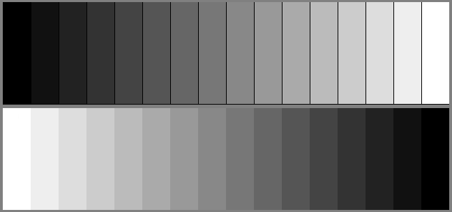

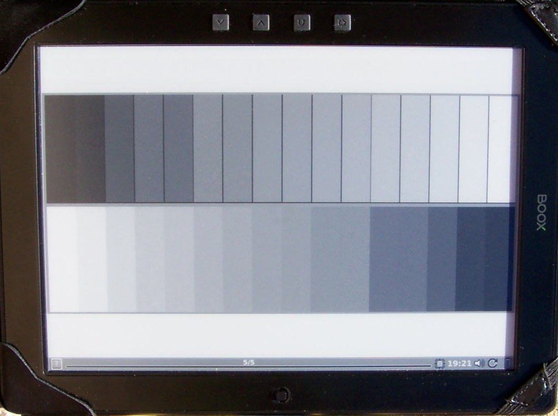

Viewing images a lot, I have noticed that the darkening steps of the 16 gray tones are not smoothly distributed between black and white. With other words, if you display all 16 shades of gray on a palette there is a smooth increase of darkness for the first 11 levels (from white to black), then there is a sudden disproportionately increased darkening between 11th and 12th. Again follows smooth darkening between 12,13,14th levels, and a second unwanted sudden increased darkening between 14 and 15 levels. The transition from 15 to 16 is smooth again.
You can see what I mean if you take a look at the attached image gray_scales_on_M92.jpg. This is the photo taken of M92 displaying the image gray_scales.gif. Basically there are two disproportionately large jumps of darkening, while there are some adjacent light shades hardly distinguishable. Unfortunately this results in a strange photo viewing experience. If the photo is light it will produce a very nice picture where the shades from 1 to 11 are used. Then if there is a slightly darker area there will be a sudden jump of darkness sometimes creating a caricature-like distortion.

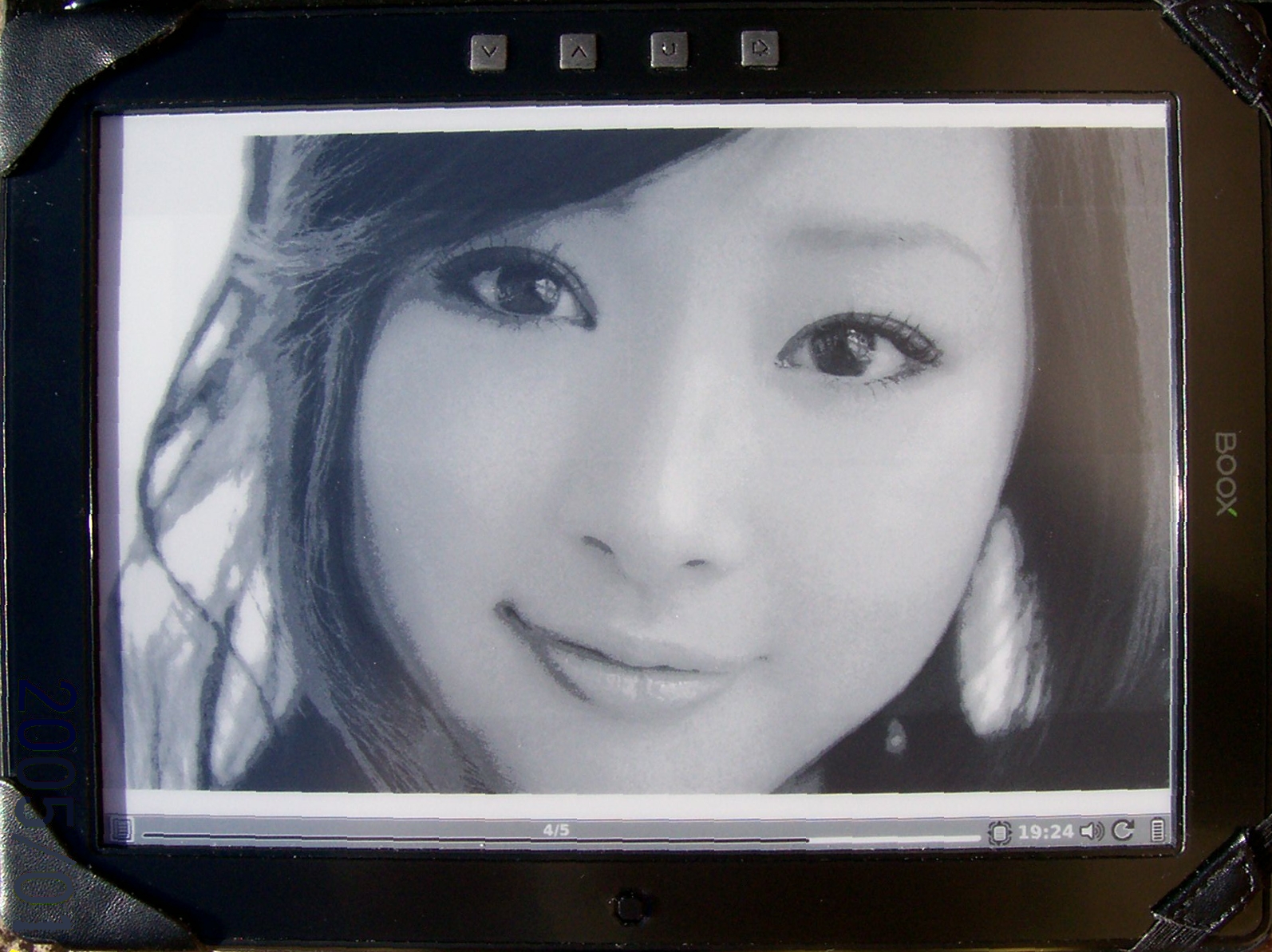

This can be seen on the sample_on_M92.jpg photo where the full_color_sample.jpg is displayed on M92. The left corner and edge of the mouth is exaggeratedly darkened. The same effect is visible at the corner of the eye on the left and the edge of the face and hair. It creates an impression of badly developed black&white photo, or a distorted image. If you convert the original full_color_sample.jpg into 4bit gray-scale (16_level_gray_sample.gif), and display it on a PC screen these distortions will not be visible. It is not too bad on this photo, but it is quite disturbing on darker photos. This is definitely a bug in M92. Most probably a software bug that uses an uneven gray-scale level distribution.

It looks like the output has only 14 shades, not 16 shades of display...

14 shades only
Yes, You are right. Now that I took a closer look, indeed there is no difference between the 10&11th shades and between 12&13th shades. So basically this is definitely a bug either in software or the display itself. It can't display 16 shades but only 14.
Can you please, (or anybody else) try to display the gray_scales.gif (attached in first post) on your M92 and check if you have the same problem? Or maybe only my device is faulty and needs to be returned...
Thanks.
Thanks.
I confirm that. 10/11th and 12/13th shade look the same.
Strange, my M92 does show 16 grades of gray. I may distinguish every shade box and none is the same like another.
That might explain, I haven't noticed anything strange concernimg b&w pictures.
