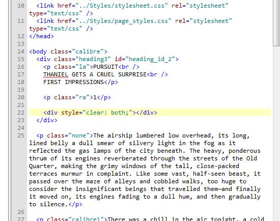

so, it seems this is failing on ADE and on Sony readers.... any ideas as to why?
The first image is of the HTML code, the second is of the relevant css, the third is the BV result in Sigil (and, obviously, calibre), and the fourth is the result in ADE (which, as I've been told, is the same result rendered on Sony readers).

Why <div clear both> ? What happens if you remove it ??
Whats class "heading3" ??? ("The style of the outher div"...)
The instructions say it need "div clear both". without it, it creates a drop cap effect around the left and right margins of the first paragraph.
http://css-tricks.com/left-align-and...the-same-line/
.heading3 {
	margin-bottom: 3em;
	margin-top: 0.5em;
(not sure what the smiley-face graphics mean....)
ElMiko is offline   Reply With Quote
Try adding &nbsp; like this:
<div style="clear: both;">&nbsp;</div>

@ yekim54— well, that did the trick. do you (or anyone else) have any idea why? A "<br />" instead of an "&nbsp;" didn't work, so I'm curious....

ADE / sony ignore empty lines i.e. those with just <br />
