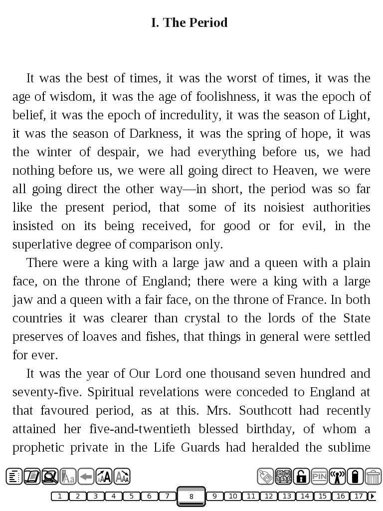

Mobipocket now looks great!
Screenshot attached showing how my native Mobipocket viewer default font now looks on a silly little Mobipocket file I produced. Looks great and is nice and fast.
This is Times New Roman. As I mentioned in my previous post, in theory you can use whatever decent TTF font you want.
In my case, after editing the various Times New Roman fonts metadata to precisely match the Iliad Bitstream Vera fonts metadata, I then simply renamed the fonts to the same filename as their corresponding Iliad font; i.e. Vera.ttf, VeraBd.ttf, VeraIt.ttf, and VeraBdIt.ttf respectively, and then copied across.
I would quite happily post up the files together with the script I wrote so that anyone on the forum here can achieve the same little hack on your Iliad, except I suspect the copyright on the Times New Roman font prevents me doing so.
What I can do, if people would like, is put up a little bundle tomorrow based around the "Liberation" font package, which is a more or less a GPL licensed equivalent font to Times New Roman, so anyone who wants a good serif font (as opposed to the ugly Bitstream Serif font) for Mobipocket need simply run the script and no longer have to put up with reading everything in "Arial" or "Ugly" style

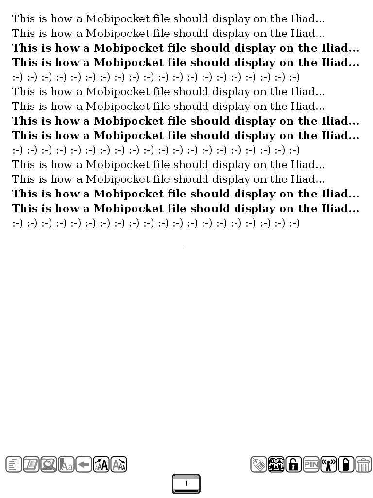

Mobipocket font switcher alpha - help needed
I created an installer package for switching the Mobipocket font to the nice and readable Liberation Serif font. But this is my first shell script, so I need someone with ssh acces to test it for me before releasing it to the public, as I would not want to brick anyones illiad.
Would this script work with the .ttf files in the script directory?
#!/bin/sh
export scriptdir=`/usr/bin/dirname "$0"`
cd "$scriptdir"
rm /usr/share/fonts/truetype/ttf-western-default/Vera.ttf
cp Vera.ttf /usr/share/fonts/truetype/ttf-western-default/
rm /usr/share/fonts/truetype/ttf-western-default/VeraBd.ttf
cp VeraBd.ttf /usr/share/fonts/truetype/ttf-western-default/
rm /usr/share/fonts/truetype/ttf-western-default/VeraIt.ttf
cp VeraIt.ttf /usr/share/fonts/truetype/ttf-western-default/
rm /usr/share/fonts/truetype/ttf-western-default/VeraBI.ttf
cp VeraBI.ttf /usr/share/fonts/truetype/ttf-western-default/
I am attaching a preliminary version of the installer for testing purposes, please use it only if you have ssh, or feel confident that you can restore your illiad if things don't work out.

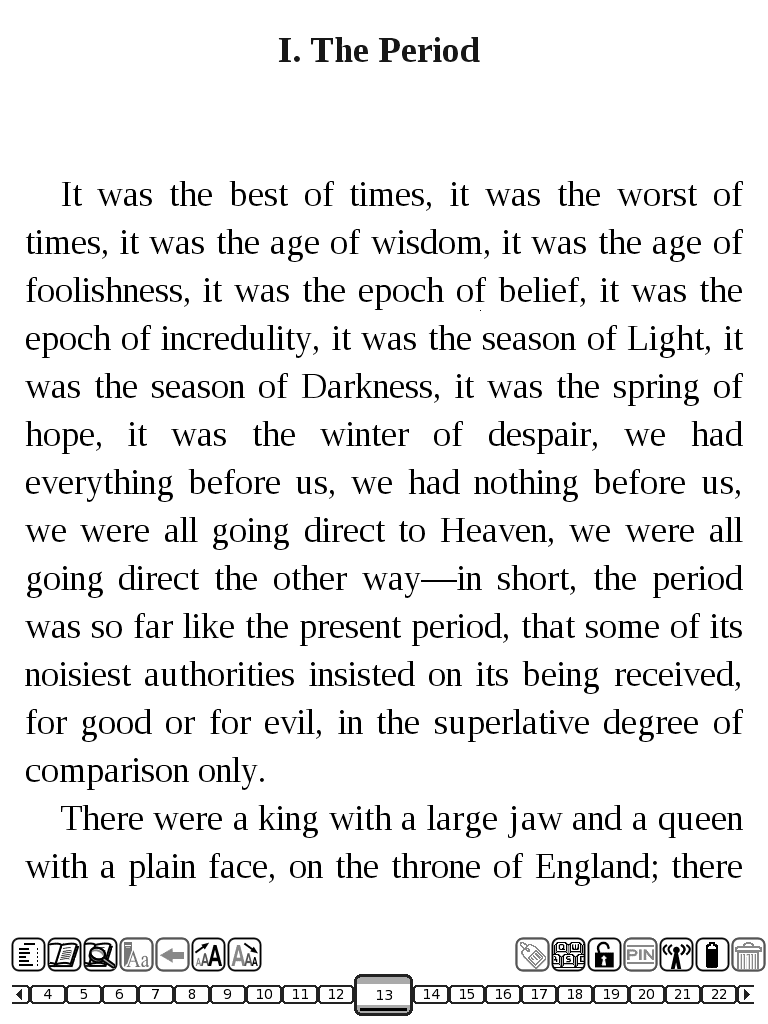

This worked for me. I was able to switch to Liberation Serif and then back to Vera Sans. I am not a fan of the result though (see the attached screenshots), I would like a darker font. Compare these to Mobipocket Font Switcher #19.
ID:	16743   Click image for larger version

Here is an updated version with a few additional fonts for testing purposes. There are two semibold fonts, I find these to be more readable than the regular version, I think this has to do with the fact that the e-ink screen is a bit gray.
