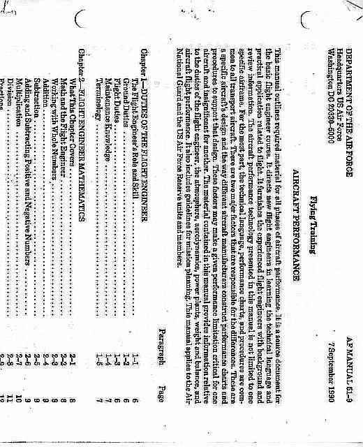

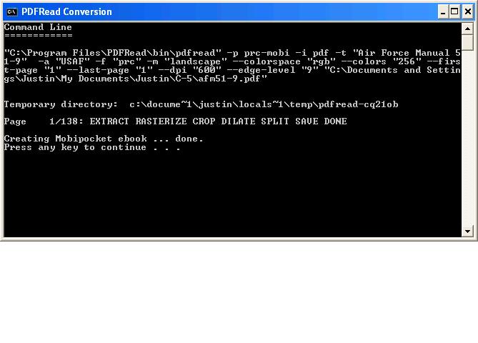

Here is page one (can't upload all of the document due to Distribution restrictions) and the corresponding CMD prompt output with the conversion.

The .prc looks ok, just it's in landscape mode (but that's what I told you to do ).
I was able to extract the images in the .prc and they looked good (except edge level is too high - try 5, 6 or 7 at most; and if DPI is too high, then the dilation looses effect i.e the bolding of the text is less pronounced!)
What exactly was your issue with using PDFRead here again? Is it skipping a page or something? Can you screen capture (Alt-Print Scrn) just the GUI input screen and upload it here?
