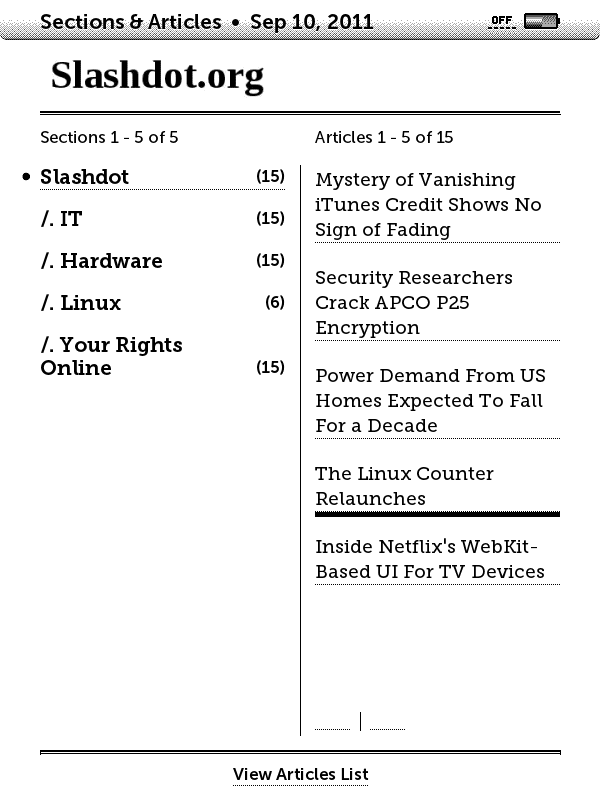

@toenne: With which fonts? Does it happen on *every* newspaper?
I've never actually used the new magazine/newspaper layout *without* a fonts hack, so I have no idea how it's supposed to look, but on my kindle, the fonts are indeed a bit smaller than the size '3' in the reader (but still bigger than '2'), and, yeah, there's no Prev/Next text on the buttons (I'm pretty sure I actually never saw it, so, for me, that's not specific to the latest build).
I've attached a snapshot, if it helps .

@NiLuJe: Your screen-shot shows the same error. At the bottom of the right column you see somthing that looks like
_____|_____
Originally this looks like
prev | next
The prev/next buttons are still working the way the schould - even if the text is unvisible.
A few weeks ago I installed Jailbreak (0.7.N), Fonts (4.7.N) and Screensaver (0.23.N). In installed the linkfonts directory but didn't replace any font in linkfonts/fonts. At that time the prev/next text were still visible.
A few days ago I installed three newer versions of the Hacks mentioned above. I also removed the linkfonts subdir from Version 0.23.N and replaced it with the linkfonts subdir of version 0.24.N. The prev/next text became unvisible.
I tried to replace fonts in linkfonts/fonts with Diavolo_K3, FertigoPro_K3 and Fontin_K3. The next/prev text didn't come back. Currently Fontin_K3 is installed on my Kindle having a smaller font within the Sections&Articles menu then the original Kindle fonts.
Please see an example at http://www.kindleman.com/help/format/ The prev/next buttons also appear at the bottom of the left (Sections-)column if the number of itmes doesn't fit on a single page.

@toenne: I have no idea why the prev/next text would disappear with some fonts, and I doubt that's anything I could do something about, unfortunately. Depending on exactly how much smaller the font is, it might simply be because Fontin just *is* a bit smaller/more cramped than the default font. You might also want to try a bci or autohint FT override, see if it helps... (Or the classic Fontin package, not the _K3 one).
