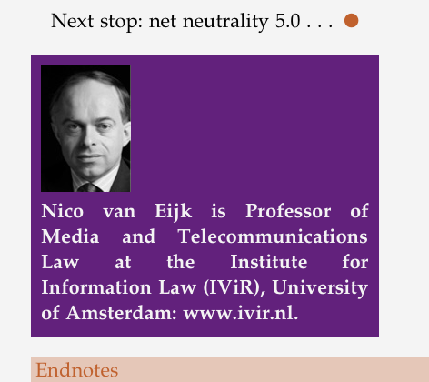

We have some text + a pic in coloured box that appears at the end of various articles within our ePub. It looks good in iBooks (see screenshot attached) but breaks down in ADE.

It may look good to you, but it's not floating or, at least, it's not what one intends when using floats.
The thing is you are using "width: 100%" for the span, so it takes the whole width of the paragraph, leaving no room for text. iBooks places no text there and skips until below the picture, while it seems ADE is placing always a word at least on each line.

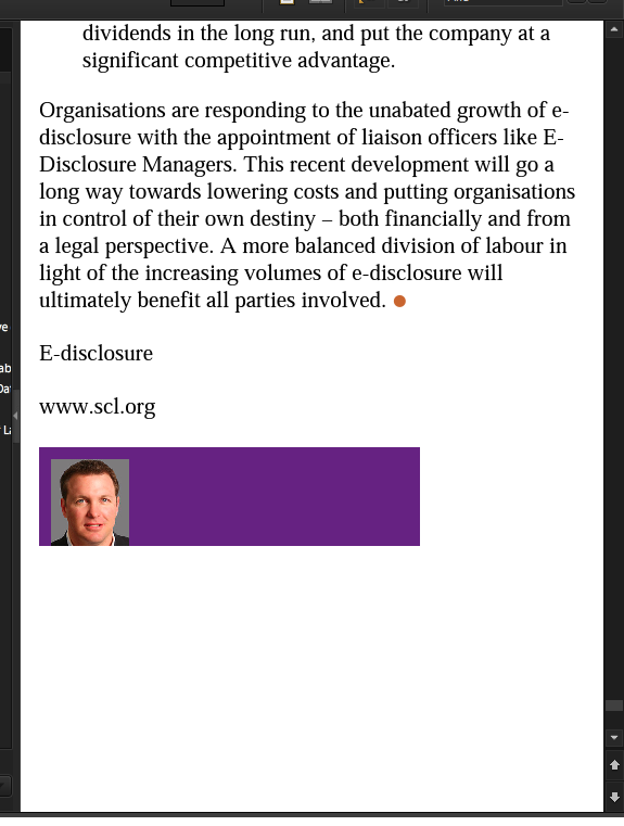

Thanks Jellby. I'm pretty sure page-break-inside: avoid isn't supported in webkit but testing it out in ADE it works, but if I then apply the span to the image using the code you suggested earlier then it splits the paragraph after the pic (see attached). The text still clears the pic (here and on other pages) but it seems to be overruling the page-break-inside: avoid.

I think I have had success by adding "page-break-after: avoid" (or -before) to the elements inside, try something like:
span.bio-blue-box-pic{
  page-break-after: avoid;
Jellby is online now   Reply With Quote

Thank you - that combination of code works great now
