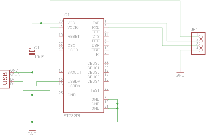

can someone send me a link to the shematics on how the ft232rl should be soldered for usage with the kindle as serialport?
It's very simple schematic, see attachment.
Hypererm is enough to establish connection with Kindle terminal. But you need some sort of Linux to import MMC0 via USB.
