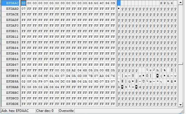

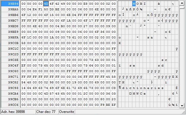

Originally Posted by LucasCorso View Post
There is nothing special with that little program. Practically all it does is open a file and put the language code at three different offsets. It finds those offsets after a sequence of 20 0xFFs or so...
hi LucasCorso,which three different offsets do you meaning,is like the https://wiki.mobileread.com/wiki/MOBI#MOBI_Header said 92,96,100?
and your program modify them all?
and I also can't find 20 0xFFs or so... in the header
I just find 16 0xFFs after "mobi"
here is my screenshot
if input 20 0xFFs in the find filed, here is the first found
