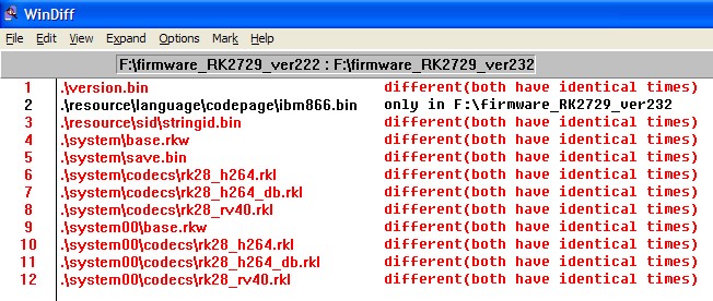

I wanted to see what files were changed within the firmware rom .img from v2.2.2 and this v.2.3.2 and note them here:
