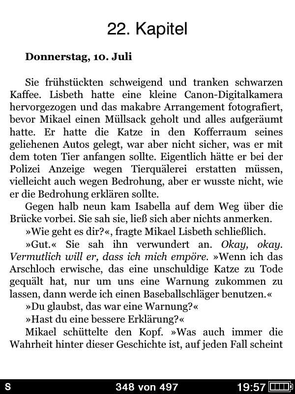

I crossed my fingers and flashed my 4 weeks old PRS-650. All went fine. Now I have Georgia as my default font. I love it.
Thanks for this great piece of work!
