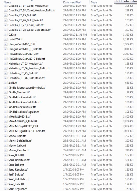

Device: Kindle 3
Nope, it's not the fonts themselves (at least not in this case ^^).
@NiLuJe
is the fonts folder inside /linkfonts/ suppose to contain this much fonts after the initial installation?
if yes, all i need to do is to, replace and overwrite the 12 custom fonts from the downloaded zip and eject+reboot.
that is all there is to see the new fonts right?
*am just double confirming the steps* tho i doubt i am following wrongly
ok, am off to work.. see u tonight

Karma: 26047224
Location: Paris, France
@nubreader: Yep, that's all the default fonts. And there was a bunch of new ones for CJK/I18N support with the K3 .
And yes, you only overwrite our 12 (or 2 or 14 for CJK/I18N, but in your case that doesn't apply) custom fonts .
And then eject, and reboot (And that's where apparently, the autoreboot of the hack isn't enough sometimes on a K3, so, let's say: full restart (either soft (via the Settings menu) if you can, or hard)) .
