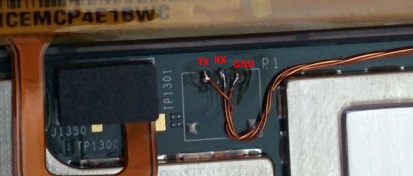

  6. Solder the thin wire to the kindle as shown
  7. Now connect the thin wire to the USB TLL Serial Cable.
    • If you use the TTL-232RG-VREG1V8-WE USB TTL Serial Cable then connect as:
      1. Kindle TX -> USB Serial RX (Yellow)
      2. Kindle RX -> USB Serial TX (Orange)
      3. Kindle GND -> USB Serial GND (Black)
    • If you use other USB to Serial connector you’re on your own

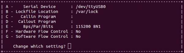

  11. Now you need to setup minicom
    sudo minicom -s
    Select 'Serial port setup' then insert into 'A - Serial device' -> '/dev/ttyUSB0'
    and 'F - Hardware Flow Control' set to 'No'
    Next 'Save setup as dfl' and 'Exit from Minicom'

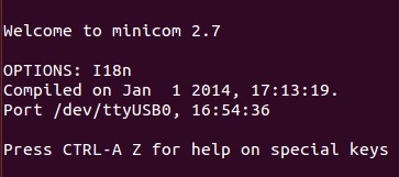

  12. Start minicom console
    sudo minicom
    You should see somthing like this
