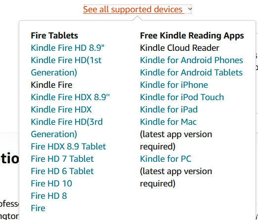

Originally Posted by Loosheesh View Post
Is there a way to tell if a book is KFX before you buy it?
If I see an See all supported devices link, it's probably KFX only. If I see something like the attached image when I click on the See all supported devices, it's a KFX with no other options.
Name:	Screenshot 2021-12-28 092057.png

Old 12-28-2021, 02:39 PM   #1377
Loosheesh
Loosheesh ought to be getting tired of karma fortunes by now.Loosheesh ought to be getting tired of karma fortunes by now.Loosheesh ought to be getting tired of karma fortunes by now.Loosheesh ought to be getting tired of karma fortunes by now.Loosheesh ought to be getting tired of karma fortunes by now.Loosheesh ought to be getting tired of karma fortunes by now.Loosheesh ought to be getting tired of karma fortunes by now.Loosheesh ought to be getting tired of karma fortunes by now.Loosheesh ought to be getting tired of karma fortunes by now.Loosheesh ought to be getting tired of karma fortunes by now.Loosheesh ought to be getting tired of karma fortunes by now.
Loosheesh's Avatar
Posts: 1,687
Karma: 3177153
Location: Jianghu
Device: PW1, PW5, iPhone SE 2016, iPhone 13 Pro, iPad Pro 9.7, iPad Pro 2021
Ah, yes, I have a few of these but didn’t know that’s what they were called. Thanks, I learned something new today
