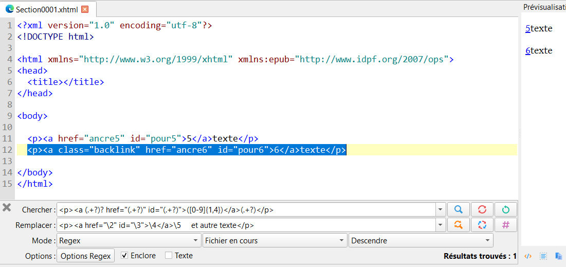

Old 03-17-2025, 04:09 AM   #767
Pavulon
Pavulon began at the beginning.
Posts: 14
Join Date: Aug 2023
Device: Kobo Forma
Use of the quantifier "?"
In automatic translation:
Good morning,
I have two identical construction links except for the presence of a class.
<a href="anchor5" id="note5">5</a>
<a class="backlink" href="anchor6" id="noted">6</a>
In Regex 101, I manage to select the two links using the quantifier "?" on the class group.
<a (class="backlink")? href="(.*?)" id="(.*?)">([0-9] {1,4})</a>
In Sigil, it does not work, I only recover the link with the class. I also tried with the quantifier "*", without better result.
Does anyone know how to tell me?
Thanks.

Old 03-17-2025, 04:49 AM   #768
Haudek
Haudek knows the difference between a duck.Haudek knows the difference between a duck.Haudek knows the difference between a duck.Haudek knows the difference between a duck.Haudek knows the difference between a duck.Haudek knows the difference between a duck.Haudek knows the difference between a duck.Haudek knows the difference between a duck.Haudek knows the difference between a duck.Haudek knows the difference between a duck.Haudek knows the difference between a duck.
Posts: 24
Karma: 111614
Join Date: Mar 2025
Location: Poland
Device: Kindle Voyage
Use this:
<a( class="backlink")* href="(.+?)" id="(.+?)">(\d+)</a>
Three comments:
1. * means that it may or may not occur.
2. you forgot a space before "class", since you already applied one before "href".
3. \d+ is the easiest way to numbers.
Haudek is offline   Reply With Quote
Thanks.
Would your regex not make two spaces mandatory between <a and href?
I would think you'd need to make that first space optional as well.
<a( class="backlink")? href="(.*?)" id="(.*?)">([0-9] {1,4})</a>
I can't explain why your original would work on Regex 101 though.
There also appears to be space between your [0-9] character class and the {1,4}, but that could be an artifact of not pasting your regex between between code tags.
I can confirm that your regex works in Sigil if the first space in made optional (or the second space really--it doesn't matter):
<a( class="backlink")? href="(.*?)" id="(.*?)">([0-9]{1,4})</a
I wouldn't have expected the original to do what you wanted anywhere, to be honest.

Good morning,
Yes the spaces are due to the fact of the multiple copy-paste between the word processor, the translator and the absence of a code block.
In fact I was wrong, I thought it worked under Regex 101, because it automatically copies in the substitution area, I had not been careful. But in fact it is like in Sigil, it only finds with an occurrence of the chain, while I ask with or without.
I would have liked, as far as possible, with the same regex (because of course, I could treat in 2 passages):
- Find all links; Whether or not this first channel is (class or other)
- be able to modify, for example group 5 of all links
- Do not postpone the channel \ 1
The quantifier ? (0 or 1), only finds 1
the quantifier * (0 or more), does not match
The quantifier {0.1}, only finds 1
Thanks

To replace:
<p><a href="\1" id="\2">\3</a>\4  something else</p>
Result:
<p><a href="anchor450" id="for450">450</a>Text1</p>
<p><a href="anchor451" id="for451">451</a>Text2</p>
<p><a href="anchor452" id="for452">452</a>Text3  something else</p>
<p><a href="anchor450" id="for450">450</a>Text4  something else</p>
It's quite an oddity! (I wonder how that one's going to get translated again...)

Newest regex:
<p><a(?:\s+\w+="[^"]*")*\s+href="(.+?)"\s+id="(.+?)">([0-9]{1,4})</a>(?:\s)*(.+?)</p>

Good evening Haudek,
Perfect, it works very well.
I understand the regex you gave me:
- a non-capturing group
- the secure management of spaces (\s+).
- 1 or more characters (\w+) up to the = sign
- between quotation marks, a set (from 0 to several) of characters, except for a quotation mark
- the non-capturing group, present from 0 to several times
but I'd never have thought of something like that. What's more, the quantifier “?” (0 or 1) works with it!
Would you have an explanation, not too learned for me, as to why the formula (.*?)? only works when the chain is present, whereas the quantifier says (0 or 1)?
I've made a note of how to do this for images and HTML entities, for another time.
Thank you very much.
Pavulon is offline   Reply With Quote
Old 03-19-2025, 06:54 PM   #780
Haudek
Posts: 24
Karma: 111614
Join Date: Mar 2025
Location: Poland
The expression (.*?)? is actually quite specific and I don't think I've ever used it. It works by matching an optional (0 or 1) group, which in turn tries to match as few characters as possible.
Look here. That "empty string" in the first line does not literally mean that something is "present."
