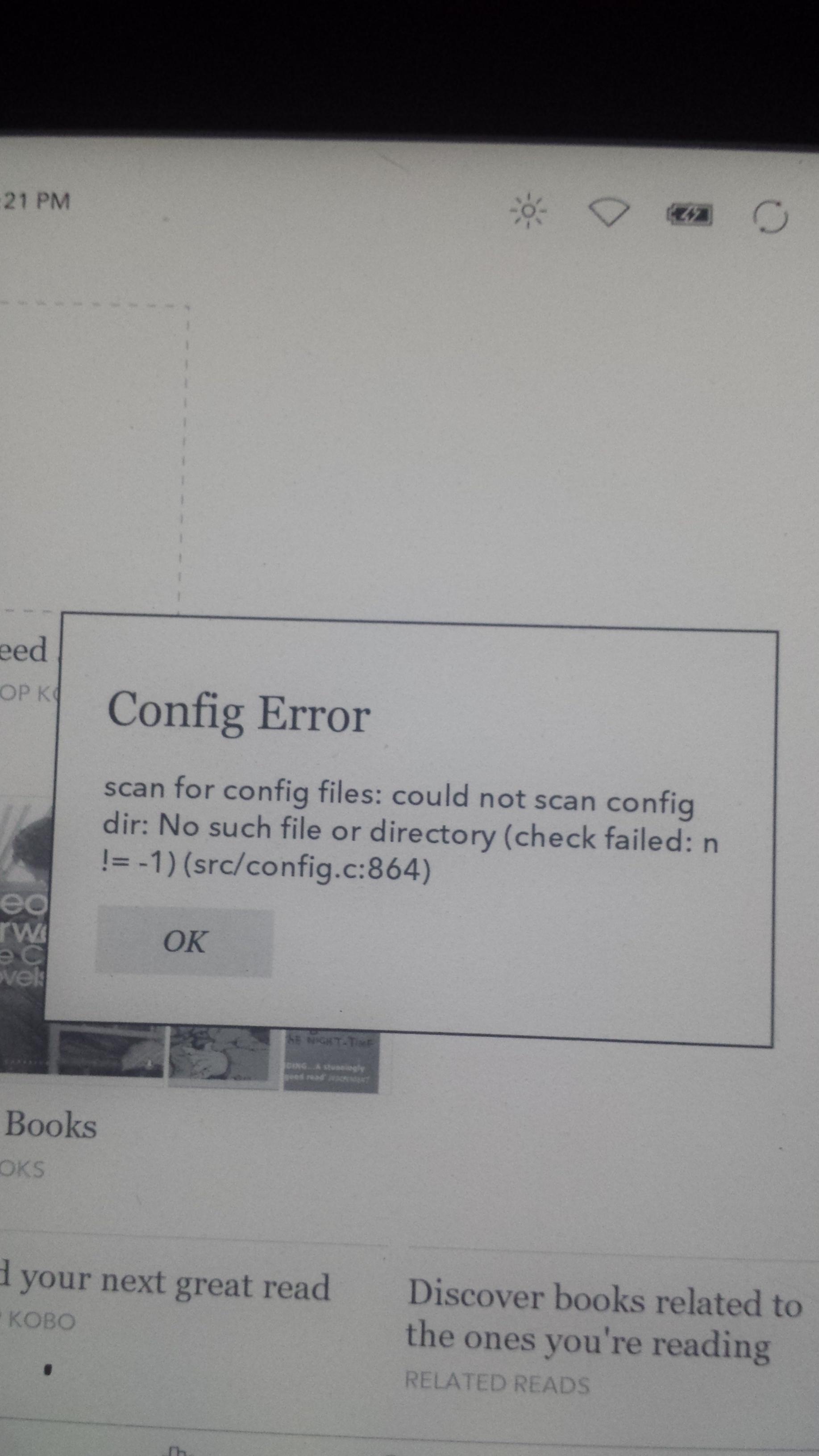

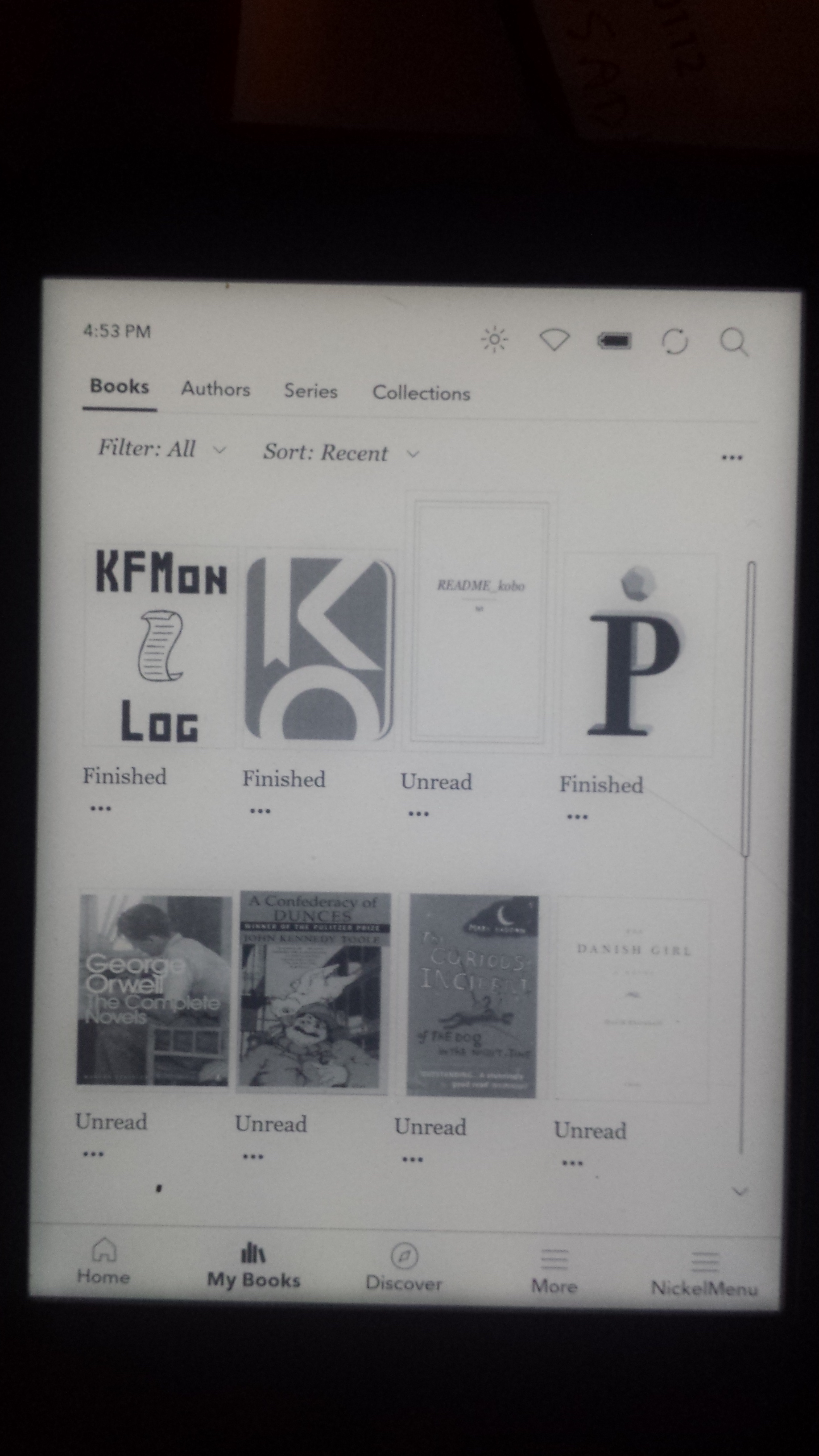

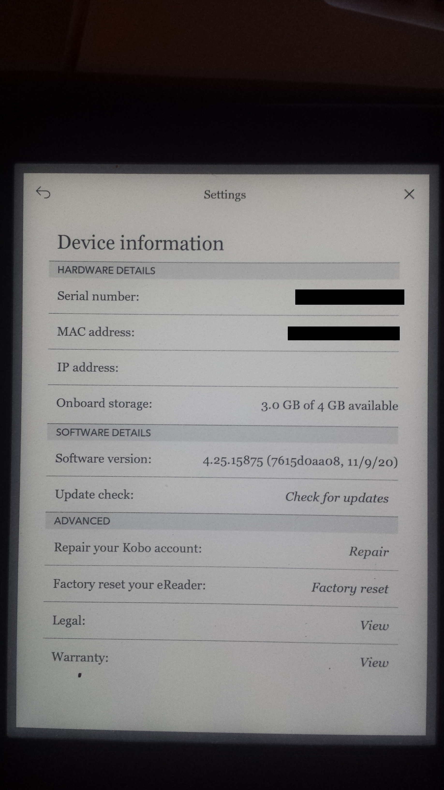

Will somebody pass on some good advice?
The Kobo Glo HD is my second Kobo.
Installing koreader on the older one was not exactly painless, but it resolved eventually. Software was 4.2.xxx I believe.
This one is refusing all advances. The trigger-files do not work. I have reset it 11 times now and used both the recent and authoritative "way"- https://github.com/koreader/koreader...mportant-notes - and older methods, in that order - but only when I copied a saved copy of the installation from the old Kobo was there a glimpse of koreader folders, but it was instantly replaced by a demand to correspond the email address on the kobo to my new account, which causes the deletion of the koreader installation... (can only use the new email now).
NickelMenu is in the bottom right corner - from the first attempts, but it supposedly should not work below FW 4.6... - and it says config error, when touched. And NickelMenu lingers through the factory reset?!
I am out of ways to try the install.
Could I somehow clear out the whole content via USB or some other way, and Really start over?
I take it that you used the One-Click Install Packages for KOReader & Plato? The One-Click install using KFMON/NickelMenu works but KSM does not work on 4.25 firmware.
If you are using the One-Click install method, are you following the instructions in the second message in the thread?
