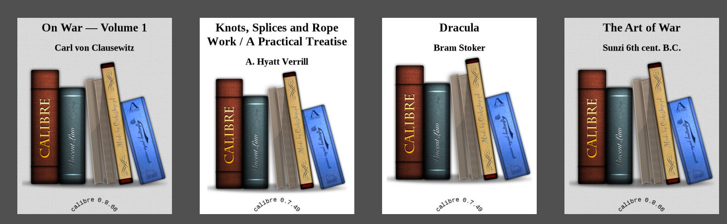

I've been using FFF since it had the other name, and absolutely love it. Thank you for allowing me to read on my iPad at work, where there's no network access. ::
The latest update (which I installed today, and yes - I did restart Calibre) is no longer putting the default Title page (Calibre "shelf" of books, with fic title, author, and series name/number if appropriate, on white background) on the fic I download. Now it's giving me the first page of the fic, like I get when I use AO3's download button. Ick.
Is there a setting for this somewhere? I looked thru the Calibre prefs and the FFF prefs. I found some stuff about the cover page in the FFF prefs, but I guess I'm not savvy enough to understand what I need to change.
Thanks, in advance, for the help.
sbjb is offline   Reply With Quote
Old 07-02-2019, 09:58 PM   #3553
JimmXinu
Plugin Developer
JimmXinu's Avatar
Posts: 7,144
Karma: 5005503
Location: Midwest USA
Nothing in the last version specifically changed how covers are handled. By default, FFF will not generate a cover (you have to turn it on), but FFF will include a title page with title, author, and several other metadata items by default.
It sounds like you had covers on and title page off, but now covers aren't generating.
How old was the version you were using? Of both FFF and Calibre.
Because it sounds like you're talking about Calibre's generated covers from the early days, like so:
Calibre stopped generating covers like that a looong time ago. And along the way, FFF's settings for generating covers changed also. There's a tab for "Calibre Cover" in FFF's settings dialog with a host of options.
The most recent version of both. But, as I said, I've been using them for years, so I may be confused as to time frame.
Hunh. I looked at that earlier. But I may not have seen all the options. I'll check it out when I'm more awake.
Thanks for the prompt answer! I appreciate it.
