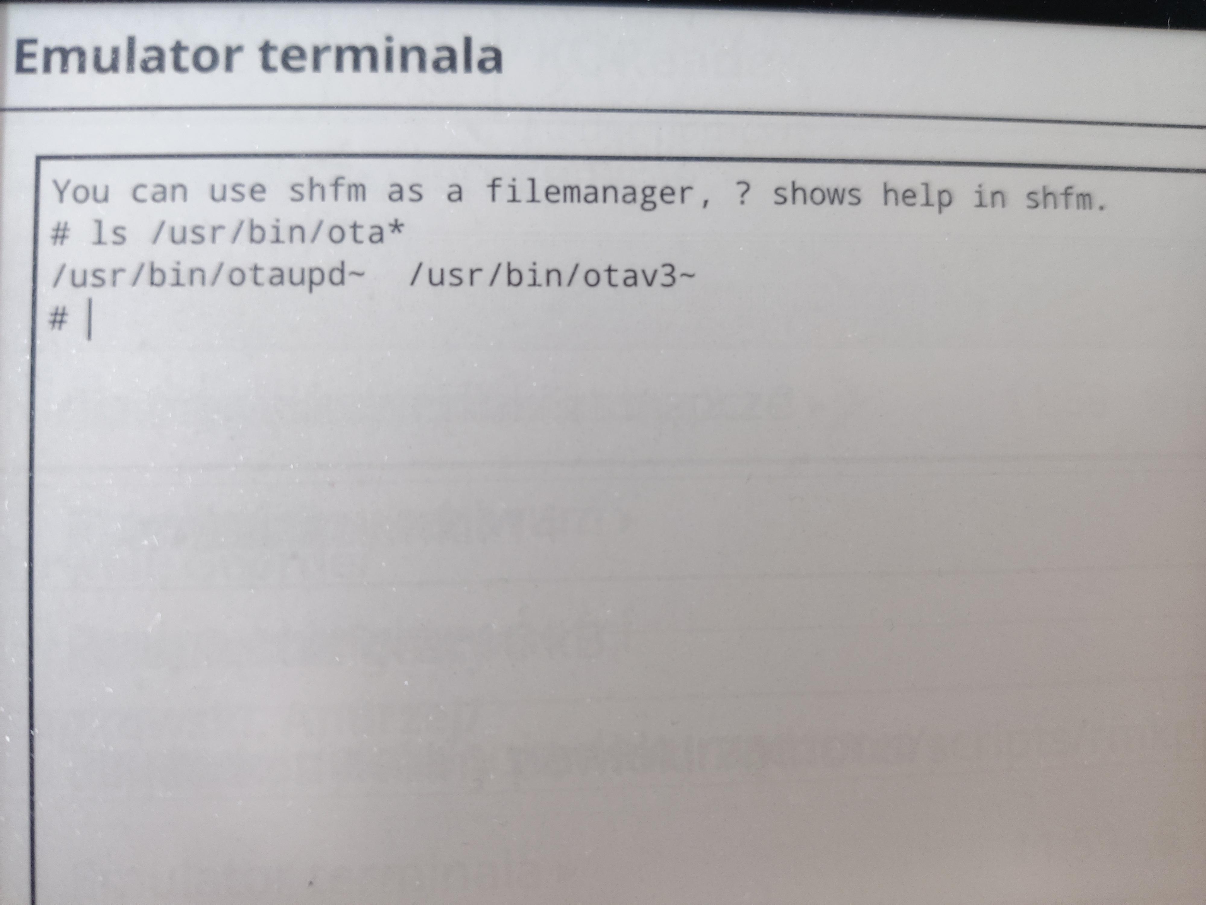

Originally Posted by arooni View Post
I ran the renameota binaries package. Then to be sure I ran it again and saw a "generating core dump" thing. Is that because I ran it twice ?
I don't think it's related.
If you select Rename a second time in Rename OTA Binaries, the Kindle just restarts.
If you used BinaryRenamer, then you won't be able to select "Block OTA Updates", because this button is replaced by "Restore OTA Updates"
Anyway to verify the binaries are renamed and updates aren't allowed ?
Is it safe to leave wifi on after running the renameota binaries !
Is this the consensus best way to keep my Kindle jailbroken?
Yes and yes.
