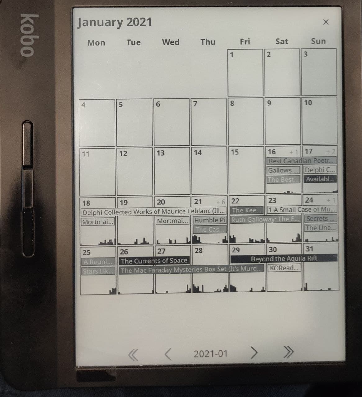

I just want to say THANK YOU for the calendar view in Reading Stats. I'd never checked it out until tonight, and it's going to be a big help keeping track of what I read and when. My VERY busy January looks kinda cool too, I think - even though I only started using KOReader halfway through. A fact which is itself quite obvious in the pic

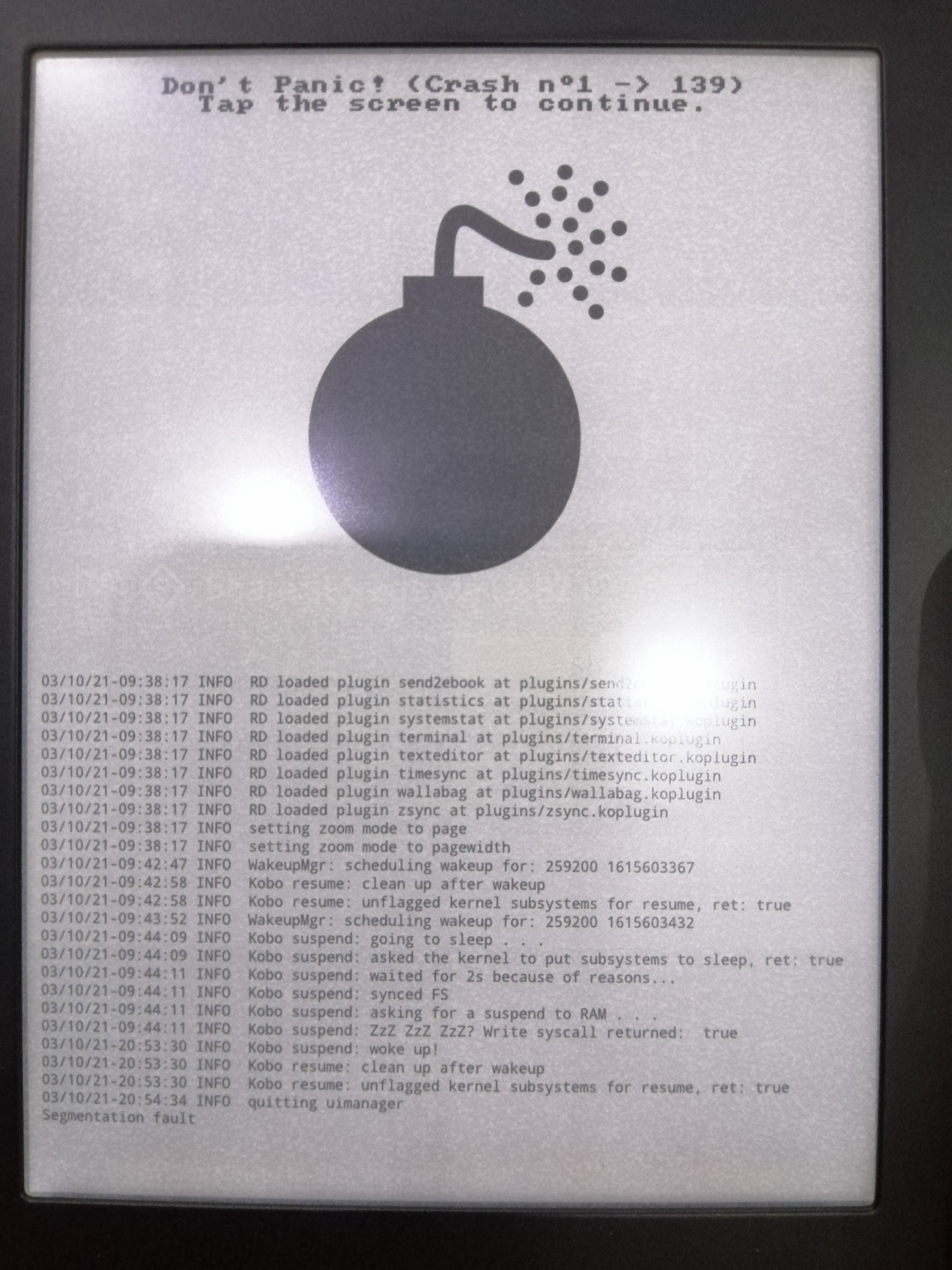

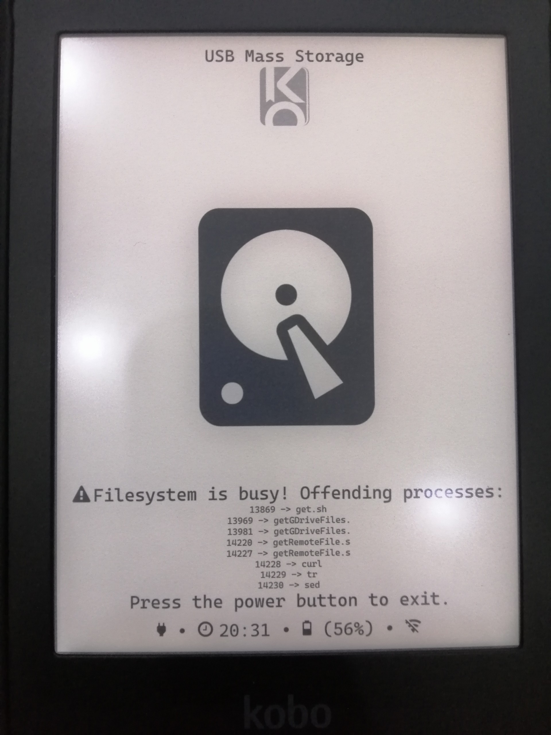

Assuming something is actually holding on to the SD card, you'll get actionable feedback on-screen instead of a shutdown
Yeah, i really don't need to shutdown, it works. But... sometimes it shows the crash screen and the shutdown screen again ). I don't know the principles.
You can enable that from the file manager, Tools > More Tools > Developer tools. Restart KOReader after
I've enabled it, what should i do next?

You have some sort of KoboCloud script installed (there are two, I don't know the scripts' names by heart). That obviously won't do .

@nhatkhoa102: "Old" and "New" is meaningless (exact detailed versions, please ).
I can't tell you anything without verbose logs, system logs, and eventually a strace (c.f., https://github.com/koreader/koreader/issues/7340) .

@NiLuJe: As i said in the previous posts, "old" is 11.2020 version, "new" is 02.2021 version
OK, i'm learning how to do this :v

Then new is not new enough, FWIW (try a current nightly) .
