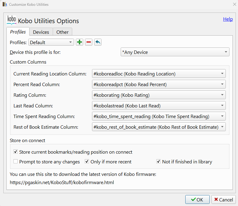

Originally Posted by TomCanute View Post
I have tried finding the version of the software running on the Kobo but cannot find it.
On your Kobo, tap on More => Settings => Device information. You should see a Software version partway down the page. Current for a Glo HD would be 4.38.23171 (6b370fffff, 10/29/24).
Anyway, my problem is, while the Reading Progress of books prior to the Kobo firmware update remains as it was, I have no Reading Progress of books read since updating the Kobo.
If you try to force the Reading progress to be copied to calibre from the Store/Restore bookmarks option, does it work?
I see under menu *Device > Metadata on device & advanced* there's a checkbox for *Attempt to support newer hardware*. Is this something I should try?
That would only be needed if your Glo HD was updated to a newer firmware version that calibre did not know about.
I also see in *Kobo Utilities* plugin options an option to backup the device database. Is this a good idea?
IMNSHO, backing up the device database is a very good idea. The best way not to need a backup is to have one.
Can anyone give me advice on what I might try to get this working again? Thanks.
I'm attaching images of my Kobo Utilities customization for Profiles and Devices pages.
Name:	Screenshot 2025-01-28 202008.png
ID:	213329   Click image for larger version
Name:	Screenshot 2025-01-28 202131.png
I updated Calibre to the latest version last night. It's now 7.3.0.
I don't know where you got your version of calibre, but the latest version is 7.24.0. That is seven.twenty-four.zero. What you have is seven.three.zero.
Did you get it from the main calibre website or someplace else?
JSWolf is offline
