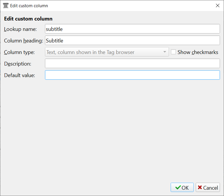

@123kajote: You didn't show what plugboards you are using but at a wild eyed guess, the subtitle field is not working. Did you copy that from the images I previously posted? Do you have a subtitle column in the calibre library you are sending the books from?

Originally Posted by 123kajote View Post
Hallo,
thanks, something is happening, but.. I get an error also PLUGBOARD TEMPLATE ERROR
You are getting that error because the template used for the subtitle is invalid. The screenshot is not clear enough for me to read. I'm not sure of what the characters at the start and end of the template. If what you are trying to do is to display put the value from a custom column with the lookup name "subtitle", then the template should be:
{#subtitle}
But, if you press the "Template editor" button in the driver configuration, it will open the template editor and show the error in full.
