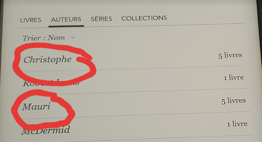

Question Authors with comma, unexpected behavior
Dear,
I use 4 devices (2 Kobo Glo HD v4.15.12920 and 2 Kobo Clara HD v4.20.14622) with the same unexpected behavior.
When I fill-in the "Authors" field in Calibre like this :
  • Name, FirstName (same that the field "AuthorSort", see below the picture with the example in Calibre)
in the Readers (Clara or Glo) one author become 2 authors.
I don't know how resolve this issue. It's perhaps a "bug" during the transfer or in the Kobo Firmware. Could you help me ?
Thanks in advance.

Old 05-19-2020, 05:44 PM   #1785
Posts: 79,998
Karma: 147448039
Originally Posted by junior76 View Post
Dear,
Thanks in advance.
The problem is the comma in the author field. It's taken as two authors. You want to put in the author as Christophe Mauri.
You can can select Authors and sort by last name or first name.
