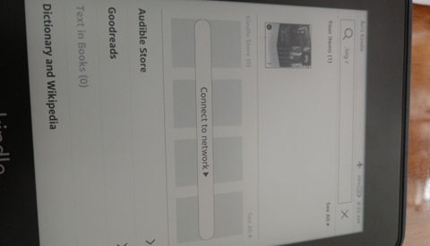

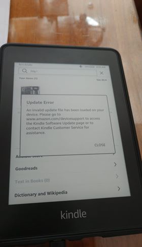

i loose jailbroken after update to 5.12.5. recent method cant be use. it tell me "An invalid update file has been loaded on your device" when eject device after copied hotfix or KUAL to main kindle storage. 12.5.4 still work but now can not downgrade anymore with same error "An invalid update file has been loaded on your device" when copy update_pw4_5.10.1.3_factory.bin and eject to use update kindle like i did on recently firmware.
but when restart device i still se notify showed up at bottom screen
*** 5.12.X ****
any chances to get jailbreak work again ?

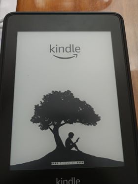

Thanks NiLuJe, this method not works.
I copied 4 files to main usb (root kindle's storage) then eject and type ;log r then no thing happen and search resur dialog appears.. i relug to PC and 4 files stil there. i restart kindle and try again these steps but no lucks, 4 files still there.
the notify **** 5.12.x **** appear
